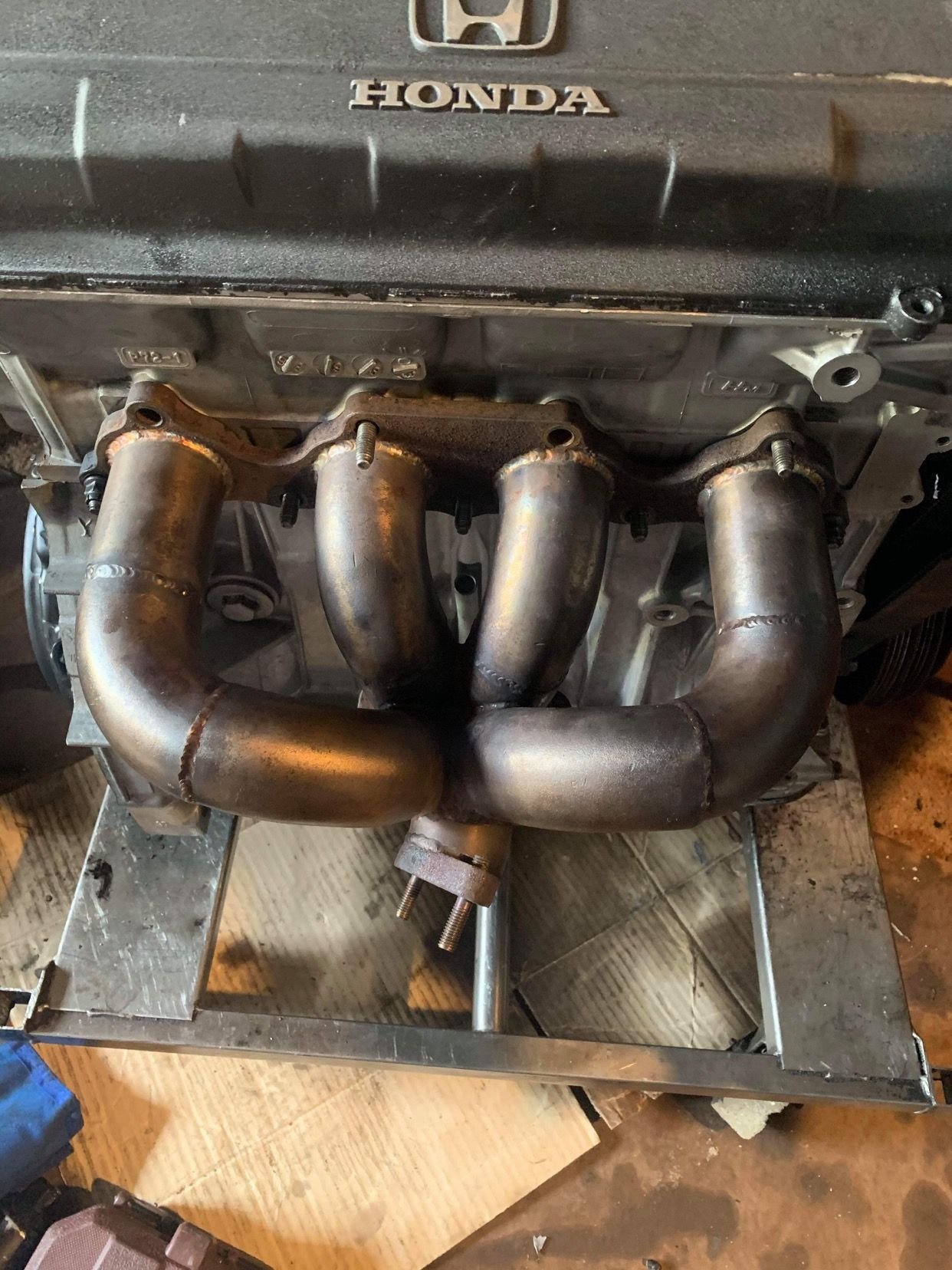

You also gotta consider wastwgate placement. Looks like that manifold has a sharp 90 into the wastegate flange. 38 or 44 itll creep.
I spent a lot of time making a nice big tear drop going into the wastegate flange. Very small creep with a 38mm and 18g turbo also with a gt2871r turbo.
Shoot some water down each runner and youll see how much makes its way to the wastegate flange.

I think you’ll be fine. If you start to go over 400 horsepower, however, then you’ll be producing lots of exhaust, so then you should switch to the 44mm wastegate.
Speedfactory makes good parts. The WG placement is at 90 degrees which isn’t ideal but it’s placed in a good spot where the collector is and it doesn’t stick out far.
