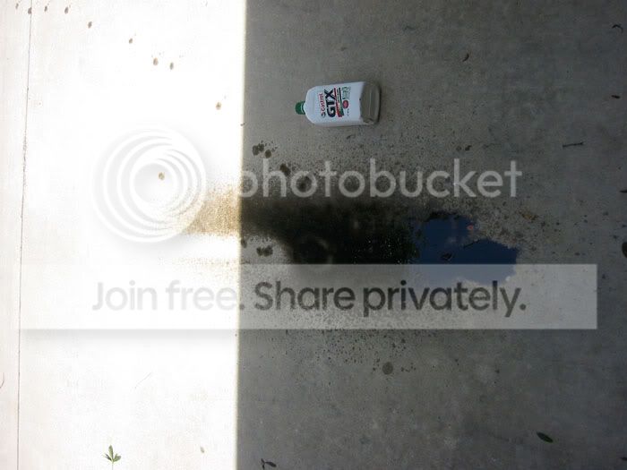

Update, I just got it started, and its doing what the mechanic said. It started smoking the instant I started it, it was grey smoke, then after about 45 seconds of idling oil started to come from the DP. It did not drip from it but blew out instead. Any ideas?
Old Jun 30, 2004 | 09:05 AM
MooreBoost's Avatar
Posts: 4,784
Default Re: Turbo Oil Problems (tegunderpressure)
Ok, this is a pic of how much oil came out after probably a minute and thirty seconds of idling.

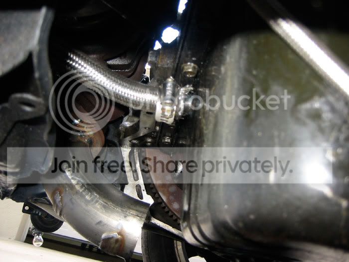

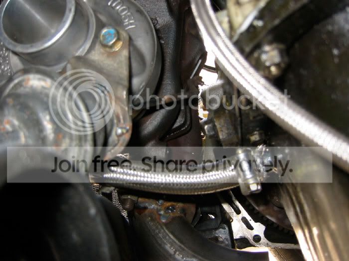

Here are two pics of the oil return.

Some of the guys at HMT think I have too much oil pressure, and thats causing problems with the seals. I did have to use a GSR oil cooler in order to get the oil feed adapter to work. I suppose that could have altered it. Someone has to have an idea...

your oil feed line is too big just by looking at the pic., and make sure that the return line off the turbo has no more than an 45 degree angel. I had the same problem and my feed line was too big and had an 90 degree off the turbo for the return line. Good Luck.

Old Jul 14, 2004 | 10:18 AM
svmnredracr's Avatar
Posts: 368
From: STP, MINN, usa
Default Re: Turbo Oil Problems (Flamenco-T)
if your asking me it was -6an feed to -10 return all you really need is -4an feed
Old Jul 14, 2004 | 12:49 PM
CRX T-Si's Avatar
Posts: 2,234
From: Atlanta, GA, USA
Default Re: Turbo Oil Problems (svmnredracr)
<TABLE WIDTH="90%" CELLSPACING=0 CELLPADDING=0 ALIGN=CENTER><TR><TD>Quote, originally posted by svmnredracr &raquo;</TD></TR><TR><TD CLASS="quote">if your asking me it was -6an feed to -10 return all you really need is -4an feed </TD></TR></TABLE>
I believe so too. Looks like a -6 at least. I was running a -4 on my old setup but then I got an oil restrictor. And now I am running the oil restrictor with the new -3 oil like that I got from http://Fast-turbo.com.
Greddy comes with a -6 oil feed line right???
Need to change the line and it should fix the problem if your turbo seals are still ok that is.
Most likely it was feeding so much oil that it was coming out of the Turbine side.
