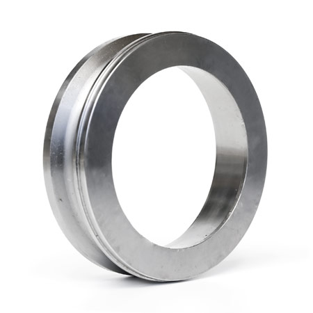

the part posted as the vband is the wrong one
HERE IS THE ACTUAL VBAND YOU NEED THAT WILL FIT PERFECT
http://www.atpturbo.com/Merchant2/me..._Code=ATP-FLS3
3" steel weld flange, VBand. Weld directly to T04 turbine housing with cast in groove to convert complete turbine discharge to standard 3" V-Band

From: Washington
Default Re: turbo downpipe help
so just weld that flange on then it should be good to clamp up to the downpipe?
Old Mar 26, 2009 | 02:12 PM
SD_Lurker's Avatar
HT White Ops
iTrader: (4)
Posts: 6,116
From: Ova Thur, United States
You got it bubba. Will fit like a glove there after!
