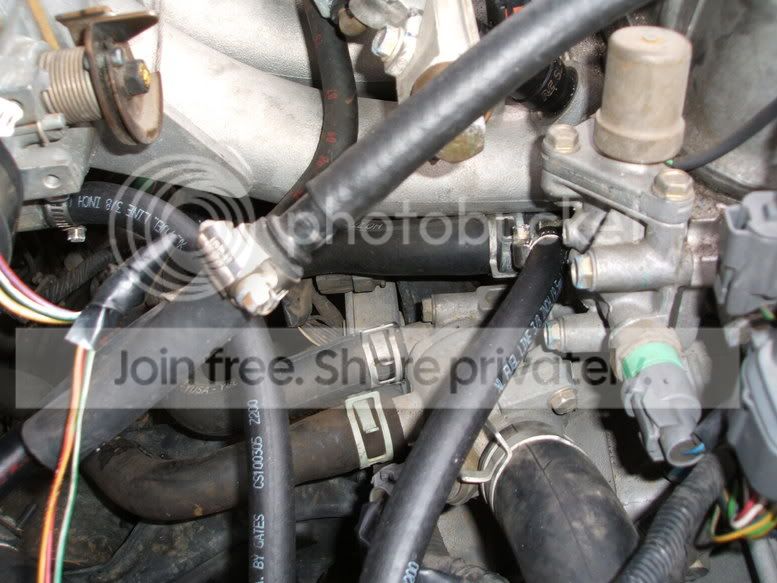

i come off the watepipe to the turbo and then back to the tb.... if you need a pic let me know its on a d16y8 tho not sure which motor you have but it wont really matter
Old Jan 19, 2006 | 04:21 PM
zeroice's Avatar
Posts: 1,232
From: fort walton beach, fl, usa
Default Re: Tapping For Coolant (zeroice)
you can see the two lines here, 3/8 inch hose
