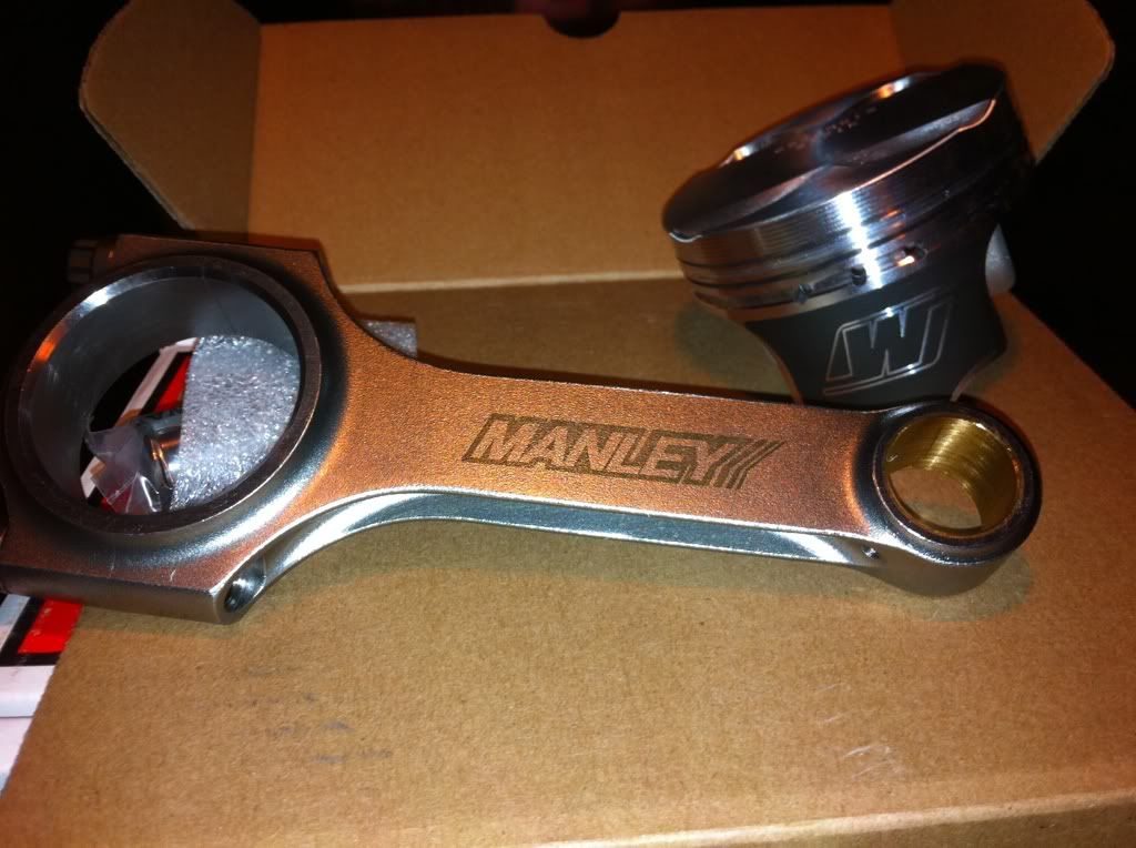

Finally!! The rods and pistons have arrived!
Cannot WAIT to take a day off work to get the block done and start rebuilding.
I think I may just finish the motor N/A and break it in that way then boost once I got some money saved up, maybe even do it over the winter once the year is over.

nice piston and rod combo
Old Feb 18, 2012 | 09:33 AM
  #97
Slacker93eg's Avatar
10 Year Member
Joined: Apr 2011
Posts: 804
From: Chicago
Default Re: Started my b18b1 tear down
Thanks, got it from Real Street Performance for an amazing deal
