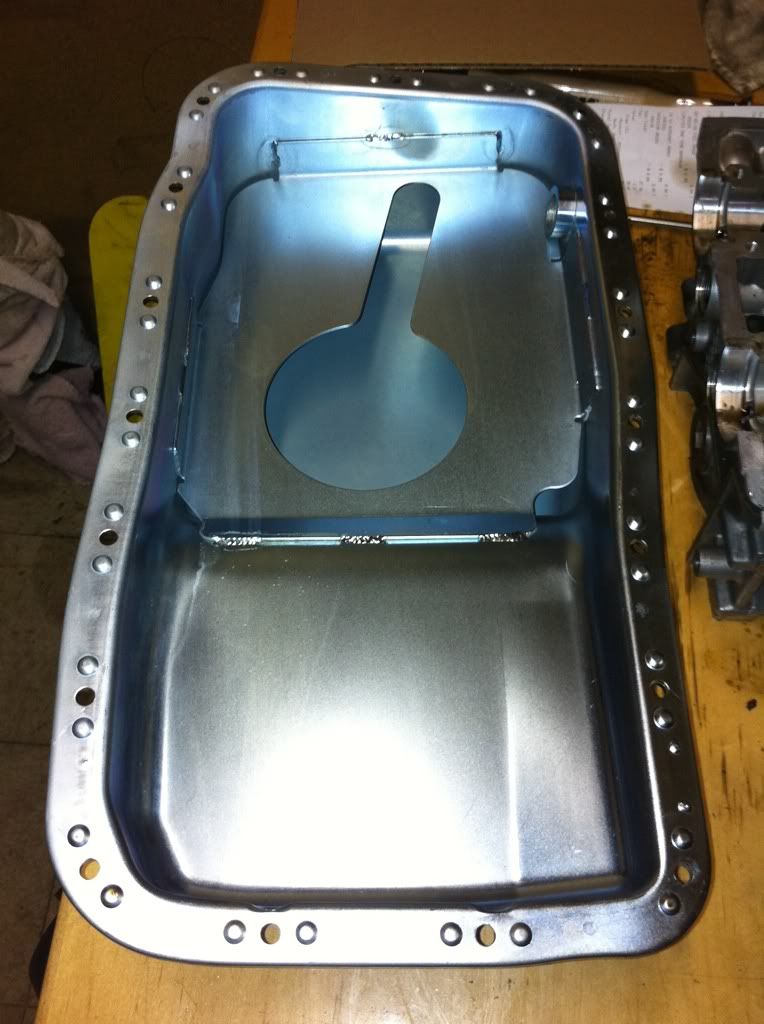

Moroso oil pan came in today, I can see what people meant by leaking where the welds are. Going to have to put some sealer over those or something. Other than that, seems to be a pretty nice piece. I have some more questions, it says the pan holds 4 quarts without the oil filter, so my total capacity should be 4.25 quarts or so right? Also, the stock LS pick up will be okay in this pan right?

Are you running a LS head?? If so, I'm not sure, but the GSR water pump might give you issues with the timing belt. I think the GSR has a bigger gear on it with more teeth and make you have to run a GSR timing belt. I could be wrong, but you might check into it.
The larger wheel is so that it doesn't cavitate in the upper RPM's.
Good looking build so far though. Keep it up!

I'm using a p72 GSR head, GSR water pump and GSR oil pump. Thanks for the input though, I'm trying to get more input I've got a few un answered questions in previous posts if you have any ideas

OK. Not familiar with the oil pump clearances, but if it's new then you should be fine. Also, I haven't dived into tranny's yet, just the motor. And the moroso pan should work fine with the stock pickup if it's made for the LS's.

Yeah it was made for the LS just wanted to make sure it would be all good. As far as the oil pump goes, it's a used oil pump that's why I was concerned. The waterpump was brand new
