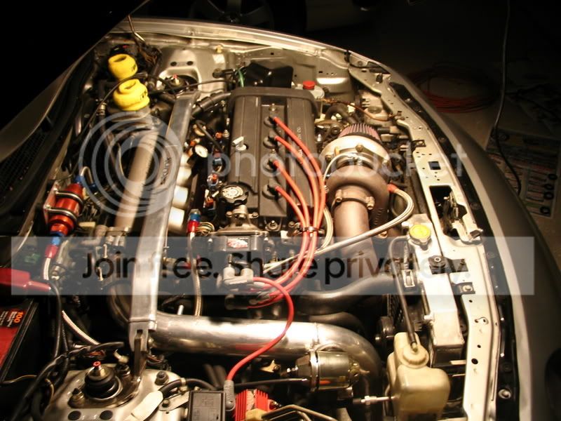

Hey everyone,
I was having what seemed to be ignitor (ICM) failure which I replaced with a new one from Acura. The car now drives a little smoother throughout the revs but the tachometer will no read past 5500/5600 rpms.
My set up:
2.0 B18B
gt35r
MSD blaster coil/ 6AL/ and cap
NGK 9 plugs
My tuner suggested changing out to the ngk copper heat range 8 plugs.
Which plugs (model #) should i get and what should they be gapped at?
---ALSO, do you think the spark plugs could be the culprit for my tachometer problem?
THANKS GUYS!
pic for good measure
