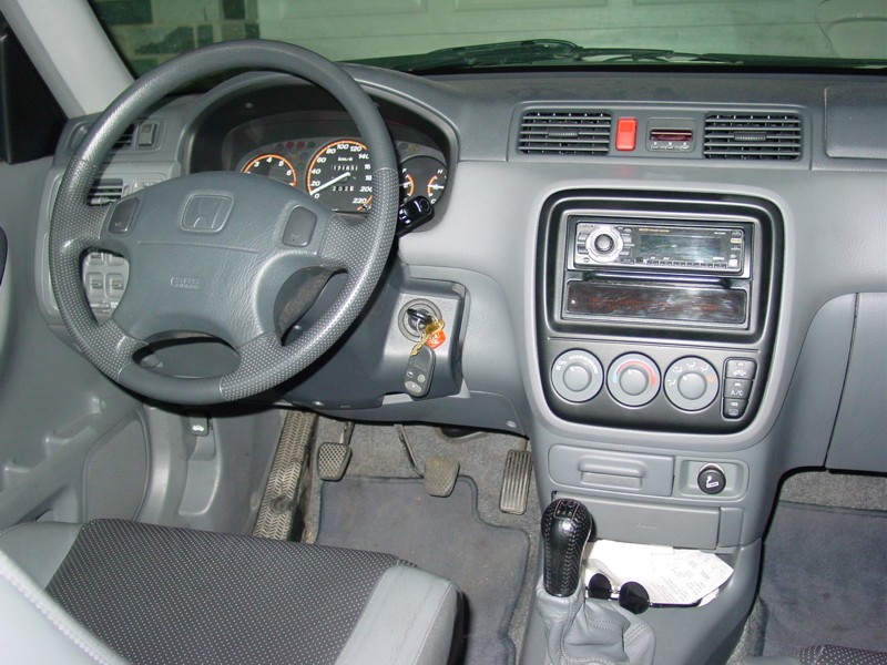

Here's how i solved it my Turbo CR-V Type R Sleeper ...
where are my gauges?
Sleeper enough?
Here's a close up, powered on ... Boost, EGT, Oil Pressure, Oil Temp.

interesting. here did u get that?

Where did you get that? x2

DOC !!
tell us how u did it!!?

dude doc where the hell did you find that thing!!!11!1

would like to know aswell!

My gauges are DIY.
The display is VFD display - yes, the one which are normally light blue, but with the right color filter it will light orange. Orange cause all other stock instruments are orange colored, too. With other filters you can let it light in intensive blue, purble, greenish blue, etc.
The eletronic behind is mainly a PIC Microcontroller. Other parts are voltage regulators (for reference voltage), measurements bridges (resistor networks), amplifier (single chip) for the EGT probe. Oil Pressure sender unit take from a cheap gauge set, MAP signal from stock MAP Sensor.
Unfortunatly i didn't make any photos during the construction state.
BTW: A other feature of this Gauges is the integrated Turbo timer

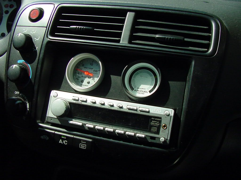

I'm gonna try to perform this
I have no idea how he got the two 2 1/16 gauges to fit with a radio in there, but i will be trying it shortly

Did you make that panel yourself?
