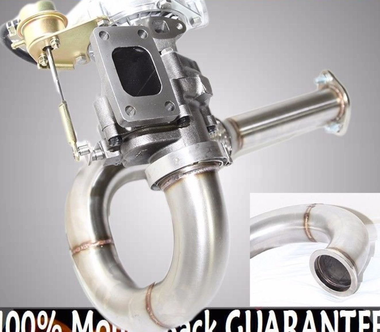

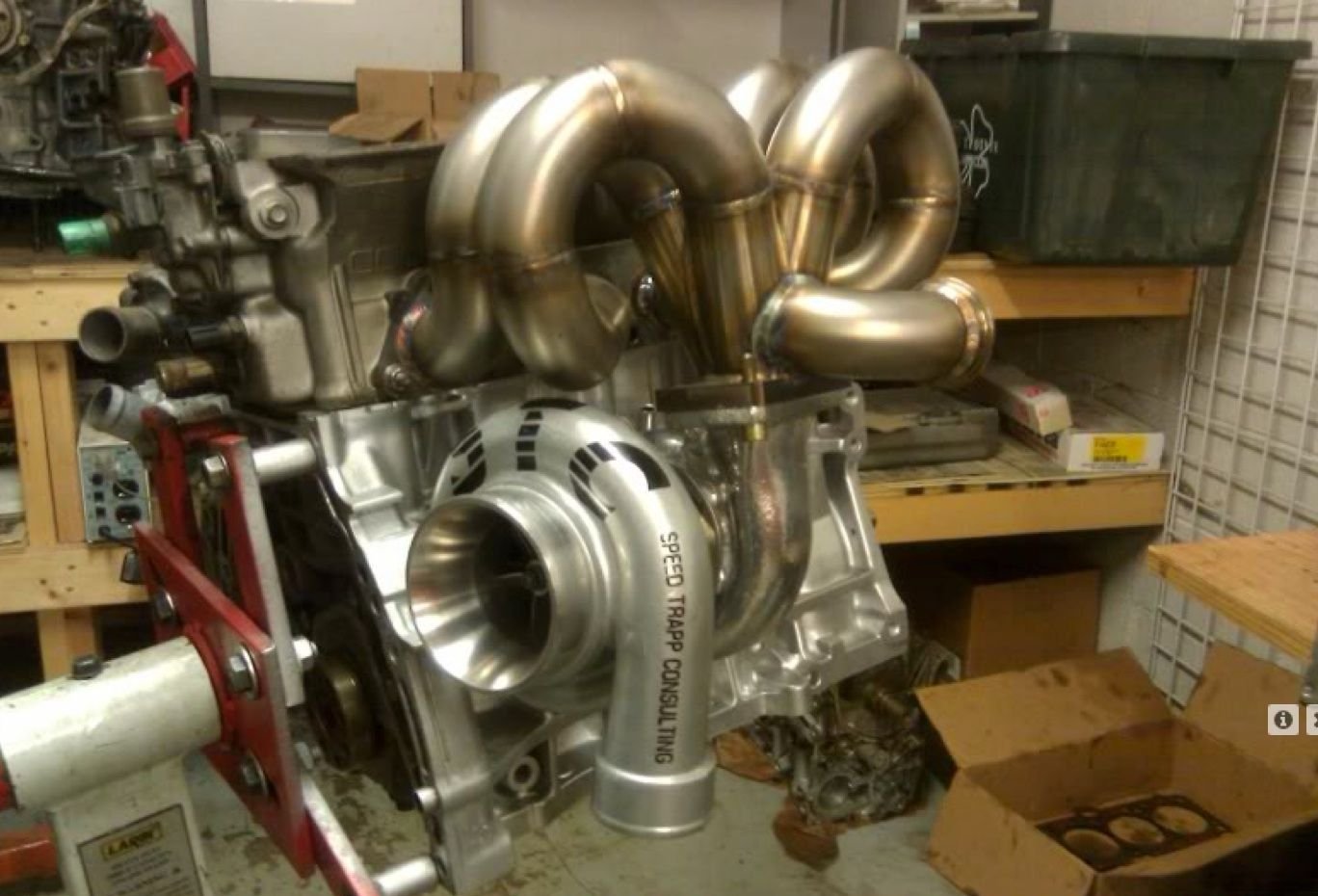

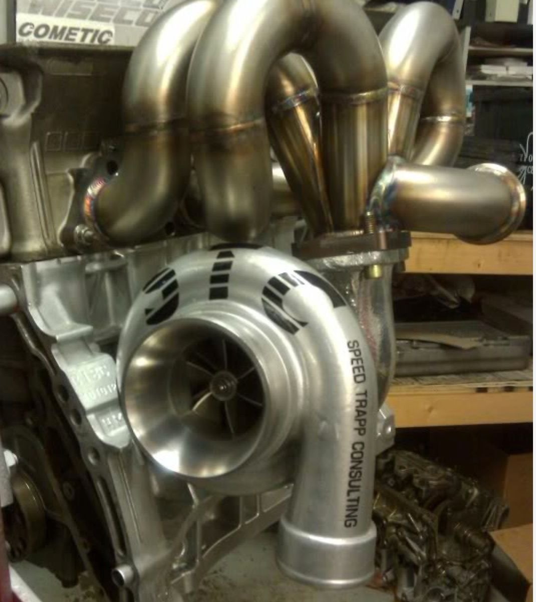

Hey guys, i have a ramhorn peakboost manifold. I went to install it today and ran into the problem of the turbo hitting the wastegate. Did some research and recently found these pictures online.
- Question is since i will need a new downpipe. Which style should work with clearance? Would i be needing something like the third picture, Ac compatible?

It's best to get the downpipe the same company as the manifold you bought, or at least one of similar design.
If your manifold and turbo are in the same configuration as the 1st two photos, you need one in 3 " that doors down under the pan.
The third photo you're showing is ridiculous. It has nothing to do with your configuration.
Check Sheepey, check Go-Autoworks.. No eBay company will have a decent downpipe for those manifolds

I'm not looking into ebay brands, only as a reference. It'll have to run from the driver side, and loop down through the oil pan, Which wouldn't that be the right type of downpipe style tho?

no. it would not. The angles on that are very much closer to the block than what your image represents. As I stated, you need to contact the two companies to get the correct downpipe.
