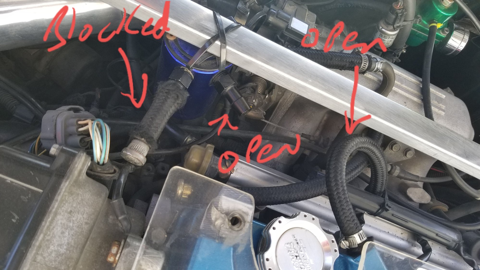

Just want to know if it's ok to run this catch can setup or if I need something better
Its a 3 port sealed catch can, I connected the line from the pcv dat runs from the factory breather box to 1 IN port on the catch can and a line from the valve cover to another IN port and then the OUT port on the catch can I sent that back to the intake manifold to the spot where the pcv would go
Jus a diagram of how it is on the car

Ye but the problem why I got this catch can was that the stock pcv system was sending oil in my intake and the trottle body would get dirty, so dats why I put the hose from the pcv system to the catch can, but I didn't connect back the intake vacuum to it

I'll have to see how your PCV system is routed. Mine **may** be different. But.. Hose from intake manifold to pcv valve? Pcv valve inserted into another hose that goes to black box on back of the block?

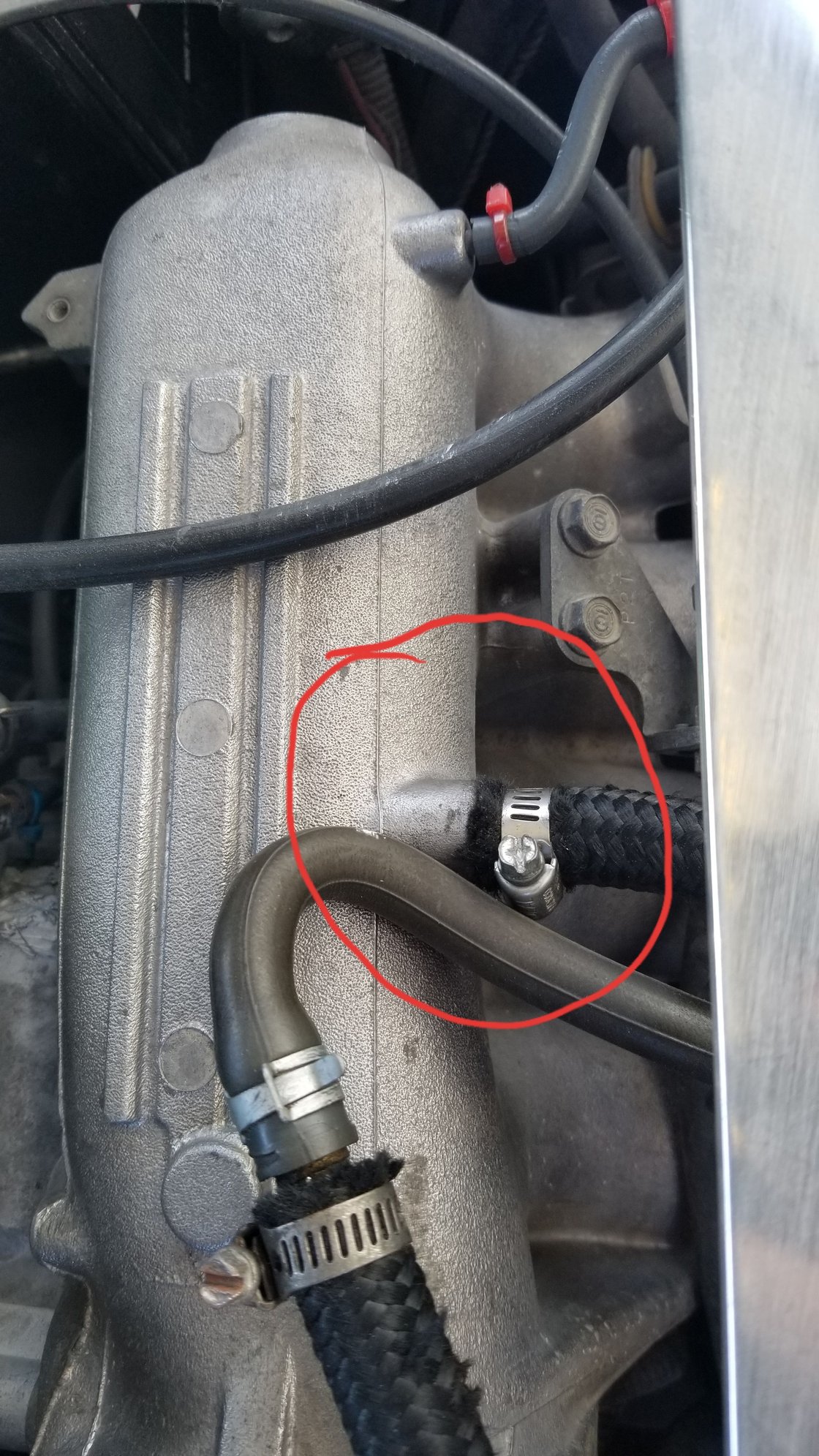

Would it cause any problems to keep this vacuum blocked off?

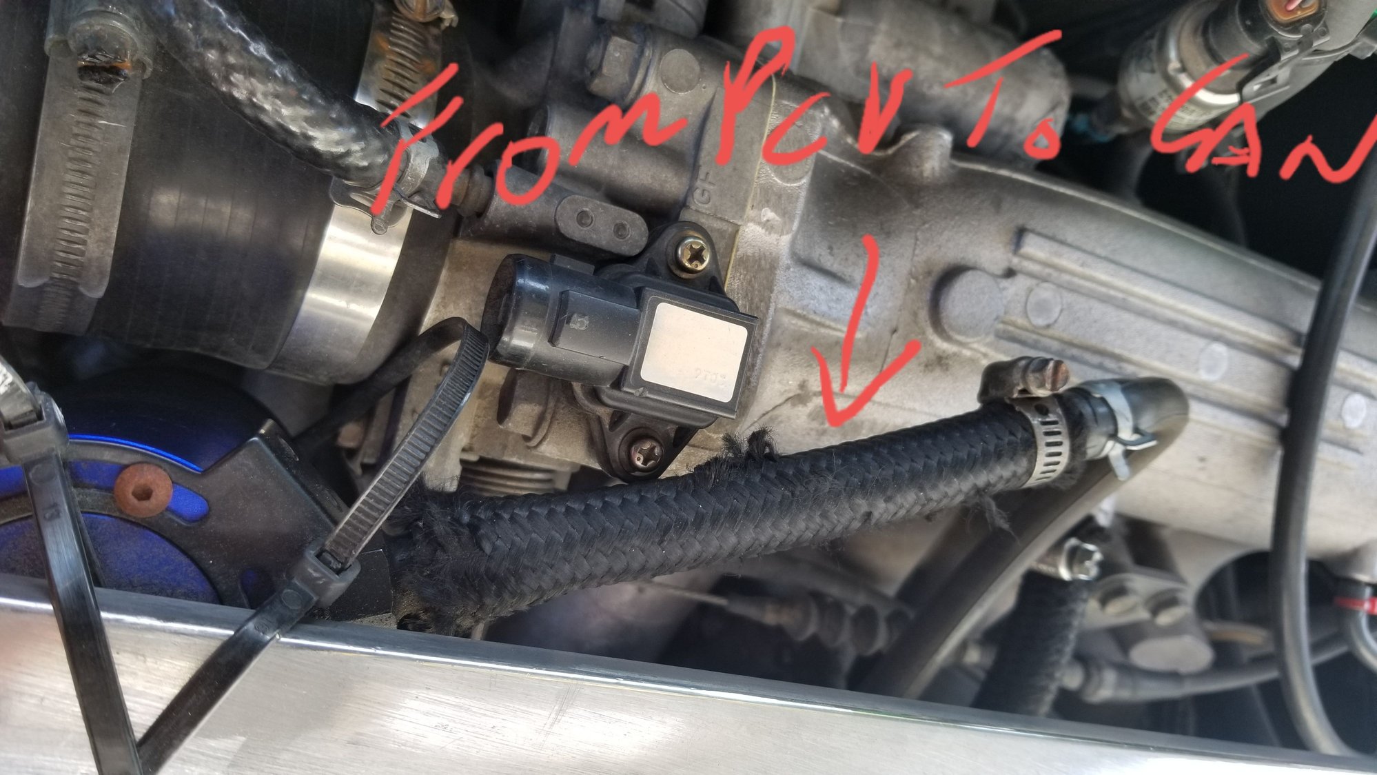

Default Re: Sealed catch can setup for turbo b16
From factory pcv to catch can

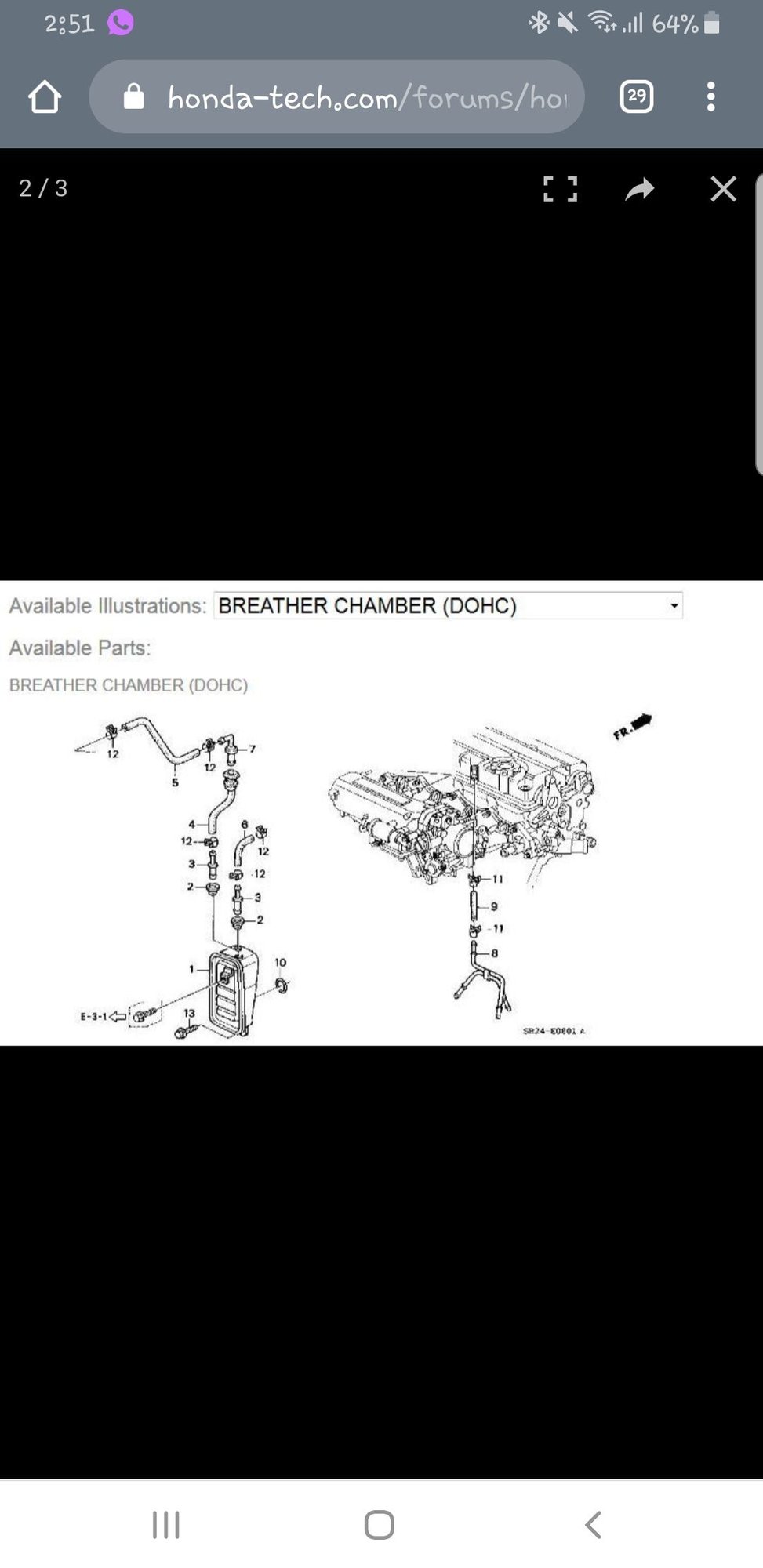

Yes like the factory b16 pvc system
This is how it was originally

Does the pcv system need a vacuum source to work or does it work jus d same if u jus leave the hose to vent?

OK so, I left my pcv components alone.. The valve can still take vacuum from the intake manifold, and the black box left intact. You're just hooking up 1 hose, to the valve cover breather port.
