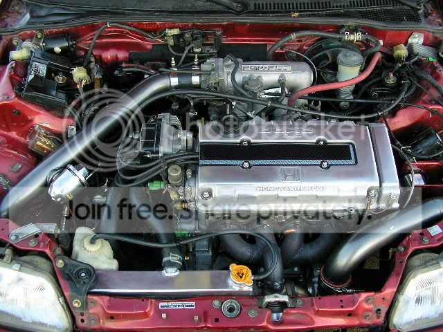

What did on my car back when i had was install traction bars with new tabs for the radiator and I used a PWR radiator made to fit in older civics.
heres a pic: I used the full-race traction bars and PWR radiator, the traction bars allowed me to use a 3" downpipe.

Love the FR setup
Too bad it's like a G for the rad and traction bar.

Default Re: Radiator problem with turbo setup. Any ideas? (EJ1 wilcox)
<TABLE WIDTH="90%" CELLSPACING=0 CELLPADDING=0 ALIGN=CENTER><TR><TD>Quote, originally posted by EJ1 wilcox &raquo;</TD></TR><TR><TD CLASS="quote">Love the FR setup
Too bad it's like a G for the rad and traction bar. </TD></TR></TABLE>
it is pretty close....I bought the stuff when it first came out.
