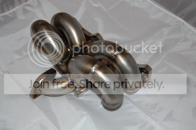

the welding/fabrication on the Race-tech is ok but far from the quality of a BWR kit.Does Race-tech have a life-time warranty like we do?

hummm, i would call a couple of those welds, undercut. but maybe it was still in the built phase.

bwr manifold looks real good
same as afi i guess?
there ramhorn manifold looks like this

No not the same as AFI, pretty much all ramhorn manifolds look the same. Just not all fabricated as well as others.

If a manifold is not fabricated and welded properly (backpurged,full penetration,beveled,ect....) it will be a lot more likely to crack.

bought a racetech ages ago on another car looked nice but was some 'fish eyes' on the welds which developed into cracks later on.. dont think his welding that good compared to other brands.. and not cheap either

Yes i got him taken care of. He should be very happy with his new manifold coming in.
We have several twin scroll and open variants for you to choose from all with warranty as well as complete kits.
Working with our parent company Kenney Enterprises we are able to CNC all of our flanges in house. We have also acquired a new welding technique because of them that is unsurpassed by any other.
The later of the two pictures are not of current welds, but just showing manifold designs.

Both brands look great! Both appear to have much better welds than the race-tech
