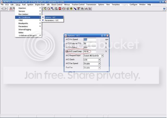

its all in the tune, i have aem ems, i used to have those problems cause we never tuned for driveability, once we did they all went away, there is a comp table to keep the car idling when the ac comes on or the stereo is bumped, your tuner may not be aware of that but it helps alot!! there are alot of start up tables that the tuner needs to play with. dont blame the hardware/software.

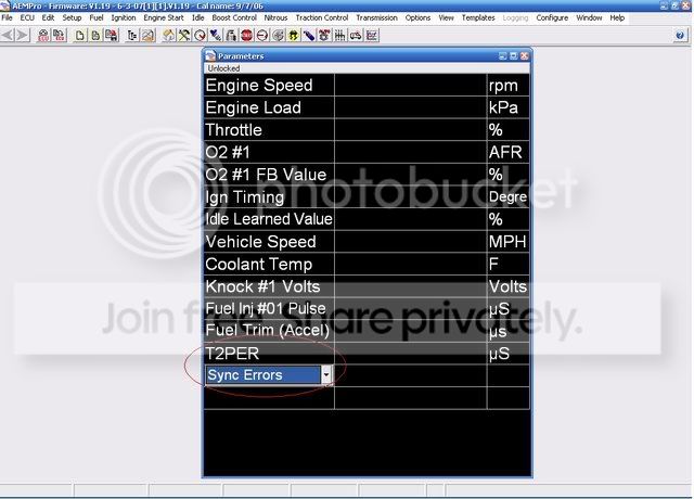

probably getting alot of ign errors at low engine rpms, then it will stall out
perhaps this needs some attention on the ac situation

Where can iget those and where do I install them? Do I have to get a re tune then? The tuner said he played with the start up maps and the maps for the a/c load. Any other ideas?
