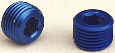

Like TD said, just use a 1/8" pipe plug. Looks like this:
Then you just need a 1/8" NPT tap (Craftsman makes these if you have a Sears nearby). Just tap the hole then screw the plug in with a bit of teflon tape or paste or even hondabond as a sealant.
