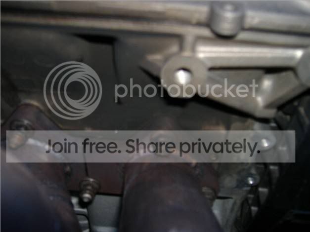

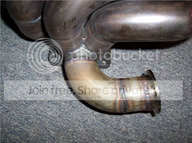

i bought a one fab manifold last summer. first problem is when i went to install it. the waste gate didnt even fit. (picture 1) so i had to pay more to have it fixed and an elbow put on so i coule put my waste gate on. that wasnt a huge deal but after a month of use it started cracking bad. it cracked at almost every runner and around the merge. well i called matt at onefab and told him the problem asked what i should do. he was cool and said he would replace it with no problem. well a few months went by and i called again. he said he was busy and would get it out. no problem i wasnt in a rush. well 9 months later i really started to getworried i wasnt gonna get it in time for my tune i left him several emails and phone calls and he gets back to me once saying he was busy and will get it out wensday well 10 months and no manifold or anything and i was forced to go tune with this manifold which is cracked all over. i didnt pay the money for a manifold that cracked this much. i wish i woulda went full race top mount. heres some pictures. any way to fix this. the money i paid for this and the money already into it to fix it is just ******* rediculous. heres some pics

new elbow i needed to get put on :

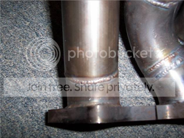

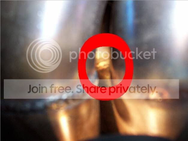

cracks (some are fixed u can see the new tig beads on the fixed runners:
cracks u can see the dark lines where it split and where the other cracks were fixed:

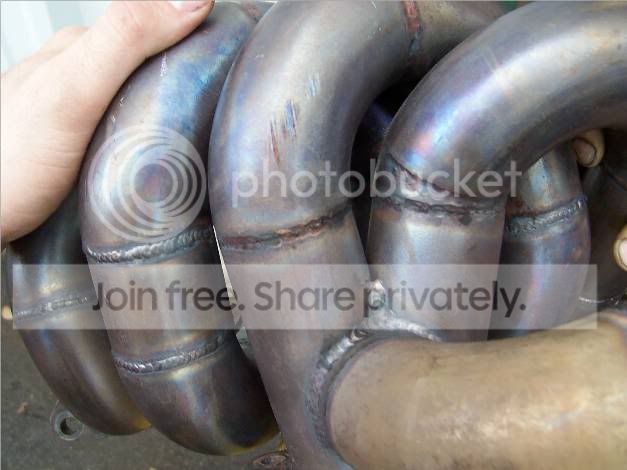

more cracks:

Welds look pritty cold and undercut , good luck with it

the beads above the metal on the left were redone to cover crack by tig welding. the others were his and they looked just fused with no filler but not 100%

those welds look like donkey ****.

from my experience, "seaming" looks good as hell but i would rather add a bit more filler and have it hold

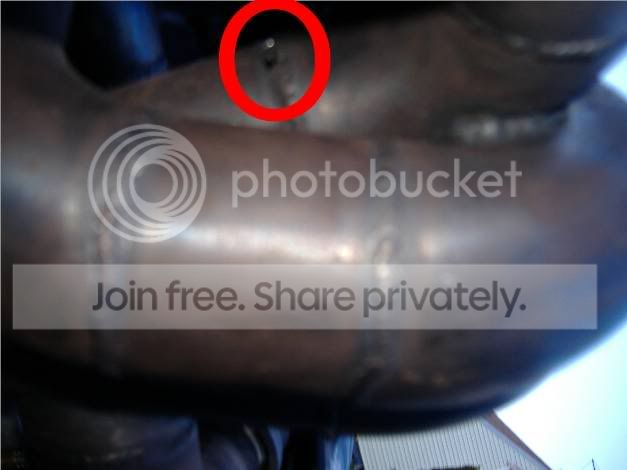

well after hearing what sound to be a nasty exaust leak i lift my hood to search around and find a nasty hole now. and i think the flange is warped and leaking bad it turned my head black and my hood and ontop my valve cover. dam this keeps just falling apart and i got no money to replace it with a new one or change to another company and have to get a new downpipe and intercooler pipe and go 5 1/2 hours to be retuned
red circle is where the crack is, its an acutally chunk missing i can fit a screwdriver in
