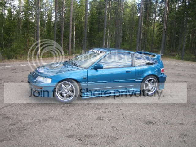

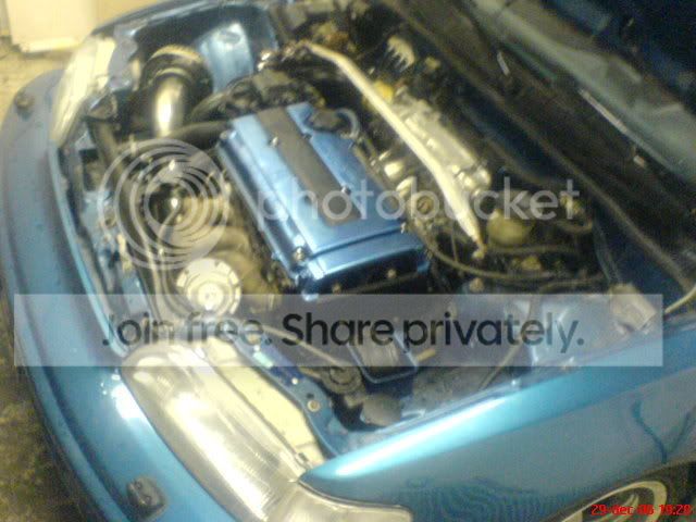

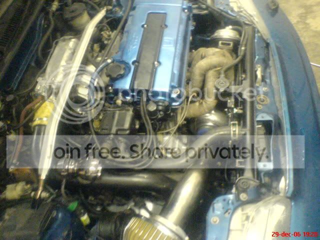

i can start
a crx vtec
b16a1 t3/t04 47 trim 3" downpipe 3" exhaust
ported cylinderhead. itr cams. 2,5" intercooler piping
ebay manifold, 38mm wastegate
550cc injectors CP pistons and eagle rods
arp headstuds
62mmTB
apexi vafc2
i had som friends of min to tune it in. they puted a chip in the box and tuned the fuel and ignition there and tuned som more on the apexi vafc2
i am boosting 15psi
