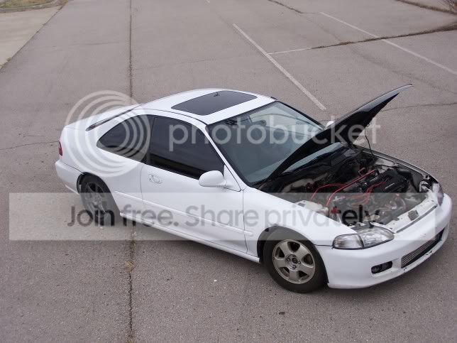

i just picked this up from my buddy, runs pretty decent, needs a tune then will run perfect......
now, if i get a block guard, low comp head gasket and arp studs, can i run like 14psi? i only boost while racing, otherwise i dont even take it above 3k. it doesnt have traction in any gear right now once it hits full boost+vtec at like 6k. i got bfg dr's that im putting on tomorrow, then it should be jsut fine though. also, the blue thing to the upper right of the fuel rail....what is it? it says vortec systems on it, is it a fpr? and yes, i also have matching wheels. it ran a 13.5 but trapped at 115, so it has 12's in it...it just needs the traction. im also thinking about a traction bar.

that 'blue thing' is an FMU

First off what are you 'tuning' it with. Since u have a FMU in there im assuming a VAFC or something of the like.
You shouldnt be looking for a certain number of PSI, you should be looking at a power goal. and more than likely you can run 14 on your stock motor with a good tune and 93 or so octane. Notice i said good tune. not an FMU and VAFC. Granted it could be done.
I cant tell if thats a b16 or a gsr.

gsr motor, im runnin 91 octane, im at a hick-college town, and cant get 93. i just wanna be safe on the motor. do ebay block guards differ from other ones? the only ones i can find are on ebay. what does fmu stand for? yea, its tuned with vfac, so its really not that tuned, i have a uberdata chip on the way, then its dyno time. im not all to concered about power, as i beat a 97 cobra with bolt ons this week i could like to run more boost, adn get a tune. i would like to be safe though, as i wont have money until i work again in the summer, at which point i see a 84mm dart block in my future im also going to try to get an equal length love-fab manifold. it has one on there now, just not equal length

Block guards are over rated do some searching honestly you should find some things. There was a thread on here about stock sleeves and what they can hold and some people were making 400-500 whp on stock sleeves so dont bother with the block guard.

I would not waste your time with a block guard. Use the money on an EMS and have it tuned. You will be suprised the results you will get with a quality ems and a good tune.
If i remember correctly the VAFC has no provisions to reduce timing as boost increases. Therefore raising your boost to 14psi will most likely be fairly risky. If you do decide to raise the boost make sure you dyno it with an air-fuel reading just to make sure your not running lean.
I know back a couple years before ems became affordable Inlinepro was producing some stock block 400hp cars using an fmu and vafc. But they are some smart peolpe and have been doing it for awhile now.
