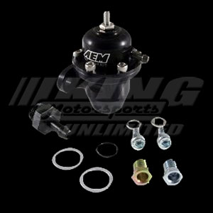

i want upgrade my fuel sys. for make 600hp and befor i do that i`ll show u what i want to buy
AEM Fuel Pressure Regulator $185.00
AEM High Volume Fuel Filter 115.00
AEM High Volume Fuel Rail 145.00
RC Peak and Hold Fuel Injectors 1000cc (where i can find cheapest one)
Walbro High Flow Fuel Pump (255lph high pressure) $109.00
i use b20vtec(sleeves) with gt35r. please if u have any info befor buy the stuff let me know

well, if you are goin for that whp, a walbro will fall off at that point or just a little behind there. some tuners can ge more.
In My Oppinion, AEM stuff isnt the greatest. i have a mis matched stuff.
vortech rail, aeromotive reg, walbro pump, and 1200's.
I DONT LIKE THE AEM REG for the past failures and i have no faith in them. i am basing that on past exp they may have fixed it, but it cost a friend his engine.

but a 100 micron post filter is necessary.</TD></TR></TABLE>
yes i have Aeromotive filter with 100 micron. but i`ll not use it. want keep my fuel syst without filter
