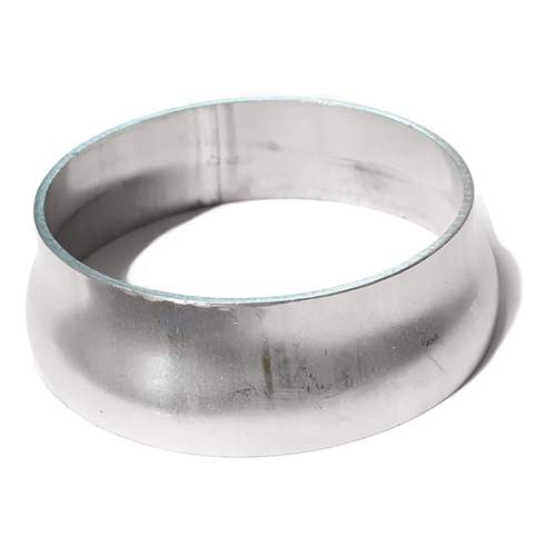

No. the 3" 4 bolt weld flange actually is 3.5" (bolt to bolt). You will need to take a 2.5" flange (same as the turbo) and use a conical opening to 3" in diameter. Only if the outer portions of a 3" pipe were dimpled to allow the bolts, could you use a straight 3" pipe from the start.

Default Re: Making a downpipe for Garrett T3-TO4E
this
to this
to your 3" bends
