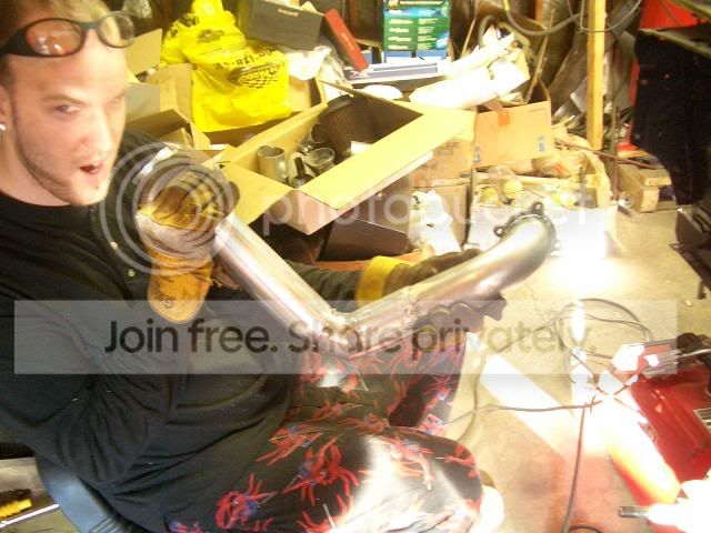

My current set-up
B18a
B16 trans
Ebay (XTD) 6puck (it was cheap, lol)
Revhard manifold
T3/T04E
9-10psi IWG
3"DP (Fabbed by ME)
2 1/4 Hot side icp (Fabbed by Me)
2 1/2 Cold side icp (Fabbed by Me)
Staintless feed
stainless (stealthmode) drain
450cc injectors
Walbro 255fp
Turboedit
<U><FONT COLOR="#22229c"></FONT></U>
Not to bad, i like it...
Im in the process of changing it all up. I have a stainless log sitting, im waiting to order my new tail WG, and im gonna upgrade to a 9" IC. when i do all of that im gonna build a new 3" DP and change up my IC piping so its not right on my FMIC. im not looking for any kinda CrAzY times out of it, but i am looking to be in the 12's on the full stock motor and some street radials. we'll see B4 long, i should be hitting up the track in about 2 weeks w/ my current set-up. i'll let you all know some times as soon as i get there!
