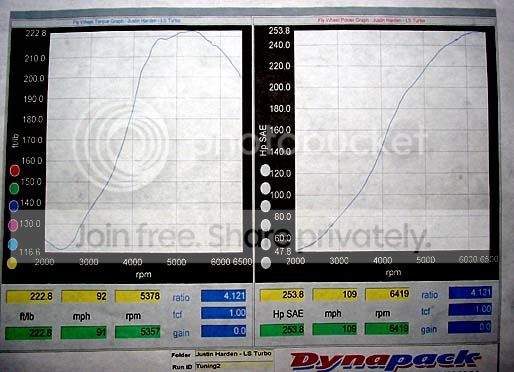

You can make a lot of Intercooler fit, some just require more modification then others. I would go with a rev-hard kit although i would change out some of the hardware and the turbo they use. Its wrong for the LS. It is possible to hit 250 whp on a stock ls. Ive done it. I wouldnt use a turbonetics, people have a lot of problems with those turbos. As far as greddy goes, THe kit is effiecient up to 10 psi, but after that has problems. The other problem with greddy the parts they use make it hard to upgrade later. I got my turbo from http://www.Speedtrappconsulting.com and repsonds beautifully. Peak numbers arent the only thing to consider, although they do look nice.
Look at the dyno above. He made 246 hp and only 212 foot lbs of torque. torque is as important as horsepower. Also look where the power is being made, this may not be where you want your power for you particular application. Choosing the correct turbo has a everything to do with what yiu want to use the car for.
Im not trashing your car or numbers, im just trying to show a different perspective. Dont mean to offend you, nor my inttention
here is my dyno

from the looks of it your turbo spools as low as the other guy who posted his but you have way more turque. your graph is axactly the way i want my dyno to be. im getting my h22 tuned tommarow and i want 230 hp and 250 ft lbs @ 6 psi&lt;just cause its an h22. is it possible to tune and purposely try to gain torque while keeping the hp numbers low?

as a matter of fact my friend just got his h22 tuned the same day i did. he put down 298 hp and 240 torque. We could have gotten more but bad plugs and a 2.5 inch exhuast with cat restricted it. as for getting more torque and less horse power. it maybe possible but i believe it will have to do with overall engine setup and turbo selection then just tunning.

It was really interesting when I configured this one. For Justateg, I was actually about 3whp and 2ft/lbs off of my original design. I accounted for the 2.5---3" downpipe, but it looks as though the E-manage tune did a bit better than originally expected. If we had the plugs changed in time, We would have easily gone for over 12psi and more torque
It's the Turbo and stroke of the engine that is going to determine more torque for you. If you have questions please PM or E-mail me at
