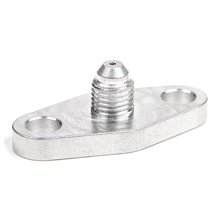

Originally Posted by TheShodan
Get rid of that OIL FEED FLANGE NOW!!! You're ASKING for this thing to be starved of oil.
You don't want this garbage with a tiny hole on the bottom. You'll starve it during low oil pressure when the car is at operating temperature.
If you must use a flanged version of an oil feed, it must be like this
where the restricted oil opening is at the TOP, with an empty space at the bottom
The BEST version to use is:
but you must check to see that it is .060-.065" on the journal bearing older Turbonetics. The newer versions (2013-present) do not need one unless oil pressure is over 100psi at cold start. Most honda B-series get to about 75psi-85psi on the stock oil pump at the oil feed line.
Can I open the hole up to .06-.065" for now until a new one arrives? I didn't take the turbo apart but when I looked in it I didn't see a shiny ball bearing but I know a lot of these older oil/water cooled turbo came with them.

If you want to blow out your seals or starve your seals, use improper fittings. If you want the turbo to last, use the proper fitting.
