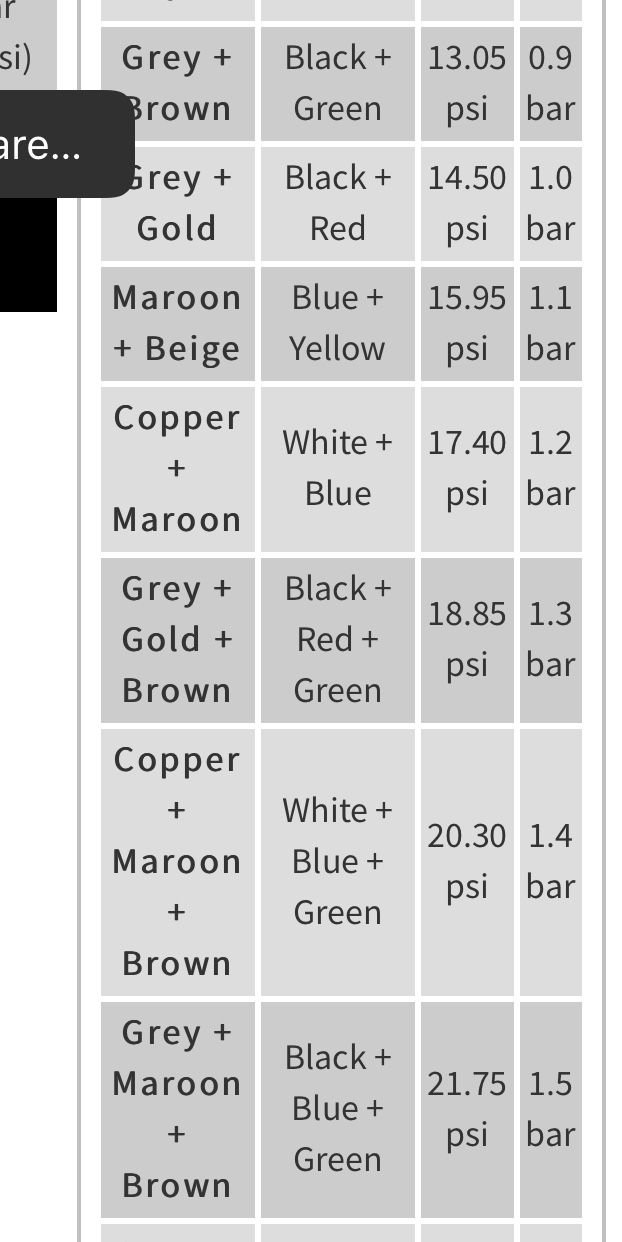

Tial MV-S old springs on left and new ones on the right.
You’re making it seem like you’ve changed one spring. Did you match this chart? For 1 bar did you do black plus red?
We did match the spring according to the table bro.
