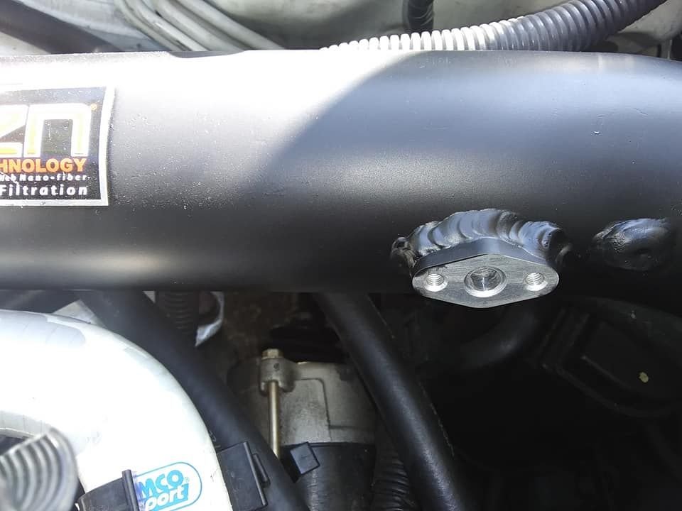

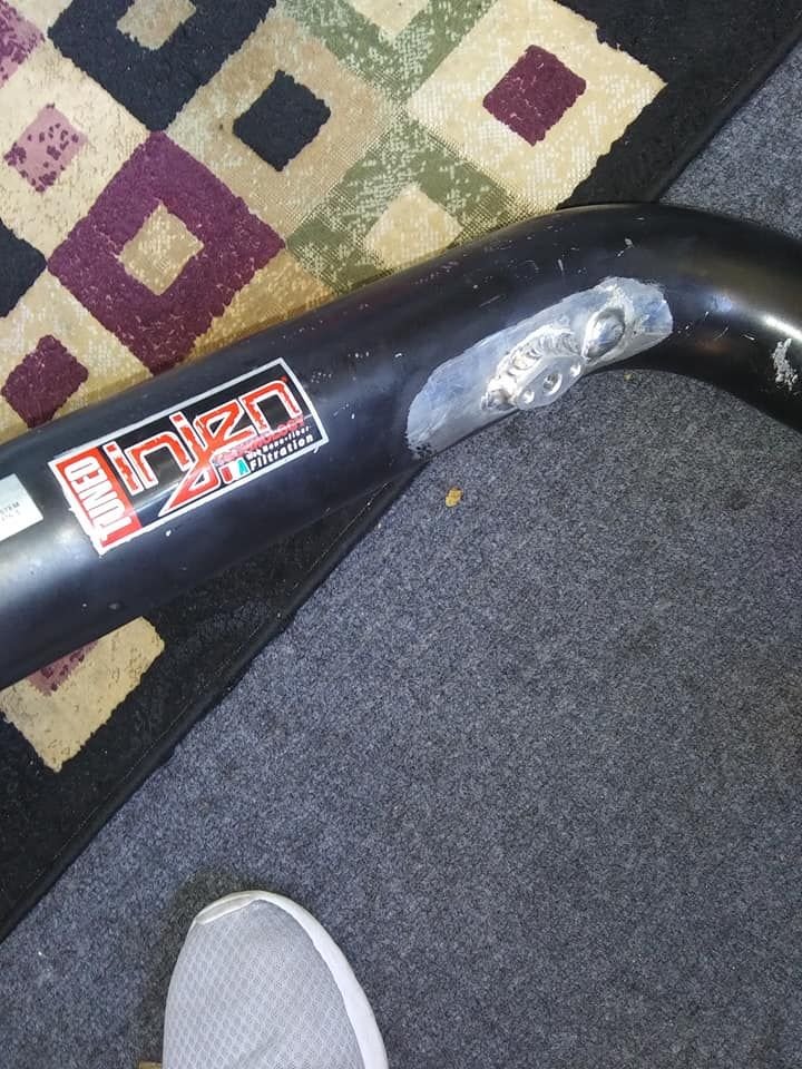

What's up guys I wanted to share my latest mod I did on my Supercharged setup. I was noticing the performance was a bit sluggish lately and so I hooked up my Hondata to my laptop and cruised around data logging and I noticed on a 75* night my IAT was reading 134* on the darn freeway! so I was stumped! my Procharger Supercharger is designed to stay cool and give the coolest air charge so I wasn't sure why the temps started to read so high or I just never noticed the IAT reading so high but it didn't make sense. My Intercooler is new no clogs or dents. So I came to the conclusion the sensor was heat soaked from being mounted on the manifold. So I purchased a IAT bung to relocate the sensor to my charge pipe and used a Skunk2 block off plate for the manifold. The sensor read high still but when I used a new one the temps read correct at 80* on a similar 75* night. Also I noticed the performance felt much better.

That's a good place for it. Mine is in a similar location; about 6" in front of the throttle body in the charge pipe. There's **some** debate on this as the temps inside the intake manifold can be warmer but, I've found no fault in running my IAT sensor this way. Gives accurate reading to the air getting drawn in.
I agree!, I think there shouldn't be any debate.., I mean at OP temp I can barely touch the manifold but I can touch the charge pipe as its much cooler to the touch. And the fact that the sensor was new when I installed it a long time ago when I had a electrical gremlin I couldn't find I replaced the IAT for good measure with no luck only to have it get heat soaked down the road.. I like the idea its reading more accurate as the IAT temp plays a big role in performance.

Yea but for me its easier to do the mod, its not that hard really to have someone weld the bung than me going in Smanager and possibly screwing something up cause im not that good with the tuning aspect although I wish I where. I like the idea of the sensor located in a cool spot compared to the manifold, I heard this is why Honda located it in this area on the K series design.
