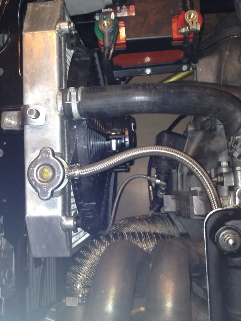

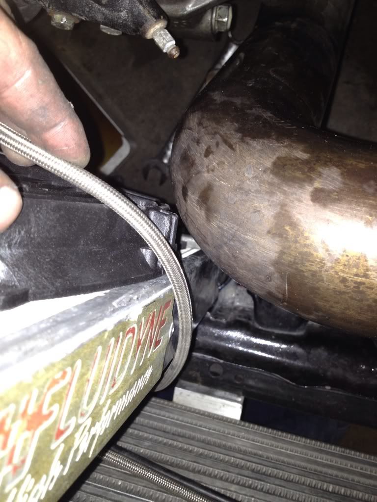

Sorry I haven't got pics yet, but I'll see what I have on my phone as of now.
Only pic I have on my phone. Doesn't show much in way of helping you. I'll try and get better pics tonight.

  #57
bcumbie's Avatar
Joined: Nov 2010
Posts: 98
From: east texas
Default Re: How hot is to hot for engine?
Hope that might help you. I want to try and add a shroud eventually.
Wow you have a ton of space in there.
Old May 15, 2012 | 05:00 AM
  #59
bcumbie's Avatar
Joined: Nov 2010
Posts: 98
From: east texas
I made a new radiator stay to pull it back a little, also I trim the core support a little to make room for it to lean back towards the bumper.
