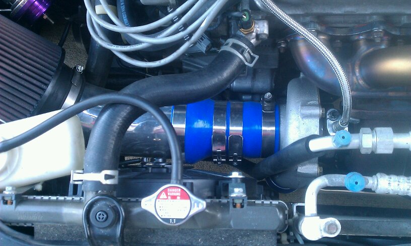

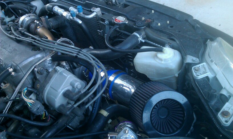

Yes I agree the stock fan moved a decent amount of air but I'm flat out of space with the turbo in there. In fact the fan I ordered today the 2044 that everyone says to get is 3.5" thick and I'm not sure I'm going to be able to make that work. I only have 2.5" between my radiator and the intake tube.
I may have to exchange the fan for the 0507 fan which is 2.5" thick. Only rated at 1275 CFM instead of 1710 but also draws half the current.
http://www.the-fan-man.com/shop/size....html?cPath=33
Tried to show my clearance... or lack there of.
In this first pic you can also see why I had to pusher on the a/c fan.
The existing fan is pressing on the intake tube you see here and it's only a 2.5" fan.

No i'm just saying, if you can't get a slim, the stock one, will do just fine. You're tight lol..real tight, so cheaping out isn't an option.

Yea that's going to be a pretty tight fit. How do you feel about running just a screen over then turbo inlet?

Not recommended in the slightest. Screens do very little to "screen" out smaller particulates. Not worth the risk.

If it were a dedicated track car I'd consider it. On the street never. I know some guys do, to each their own. I've been building engines and tearing them down long enough to know I'll personally never do it on a street car.
