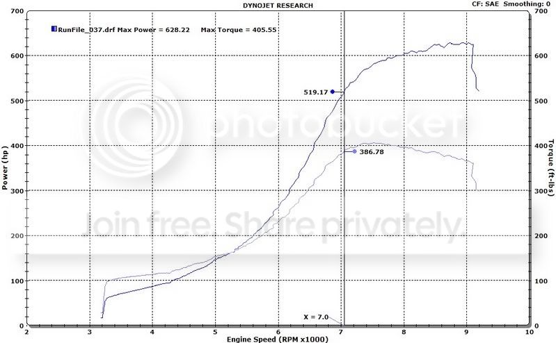

My bad, it was 628whp SAE
Here's the setup, for the Haters...
83mm B16A
Stock B16A Head w\ Springs and Retainers
ITR Cams
Full-Race Undivided Top Mount w\ 4" Downpipe
Edelbrock IM w\ 72mm TB
SC6176SP .68AR T4
Walbro 255hp
PTE 1000cc Injectors
Neptune
Correction Factor was 1.02, made 618whp Uncorrected.
