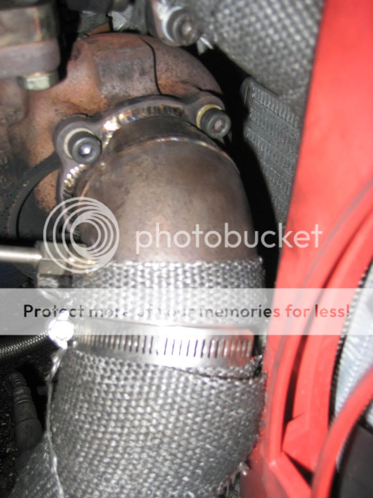

I have used red and blue lock tight. Lock washers and have redone this about 5 times. The four screws that bolt the turbo to the downpipe keep rattling out. Any suggestions on some sort of screws, I thought bout just tap welding it.

how r u gonna weld stainless to cast?
Old Mar 8, 2008 | 01:09 PM
cameron4776's Avatar
Posts: 131
From: Kingsport, TN, USA
I'm not familiar with welding, but I was going to tap weld the bolt to the downpipe.
