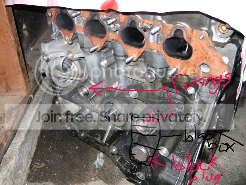

I bought t1 fittings for the back of my block so that i can vent it to and run it to an oil catch, does anybody know exactly where these take pklace of? ik there in the back of the block but iv herd b4 from somebody that you also have to take off the "black box". LMK
Pics would help alot too if you have them or know where to find them

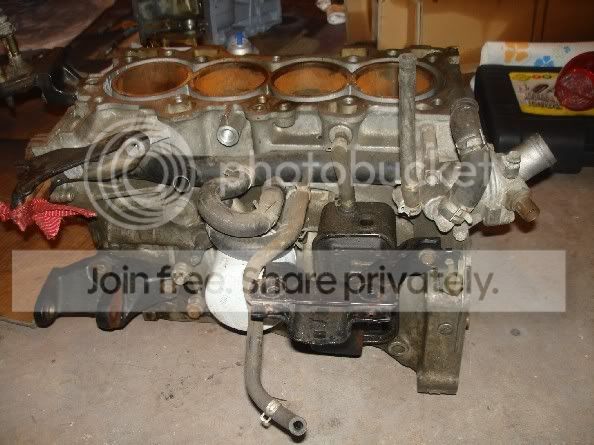

You have to remove the black box and two freeze plugs with a large hex head. The freeze plugs are in there with red loctite so they can be a bitch to get out. You need a block plug like the z10 one in the picture, or you can order a much less expensive one from T1 that works just as well. Check out the official catchcan thread for more info -- too bad all the pics there are broken.
The first pic is just to get you oriented (took it from this f/s thread: https://honda-tech.com/zerothread?id=2221283).

There are two lines coming out of the black box that will be removed from the motor with the black box. One goes to the PCV valve in the valve cover, and one goes to the block (location visible in first picture). You can cap off the fitting for the black box hose on the block with a dead ended piece of rubber hose. You'll need to plug the hole in the valve cover with something.
Only diff between ls and gsr is the location of the pcv valve. PCV on ls is in the valve cover.

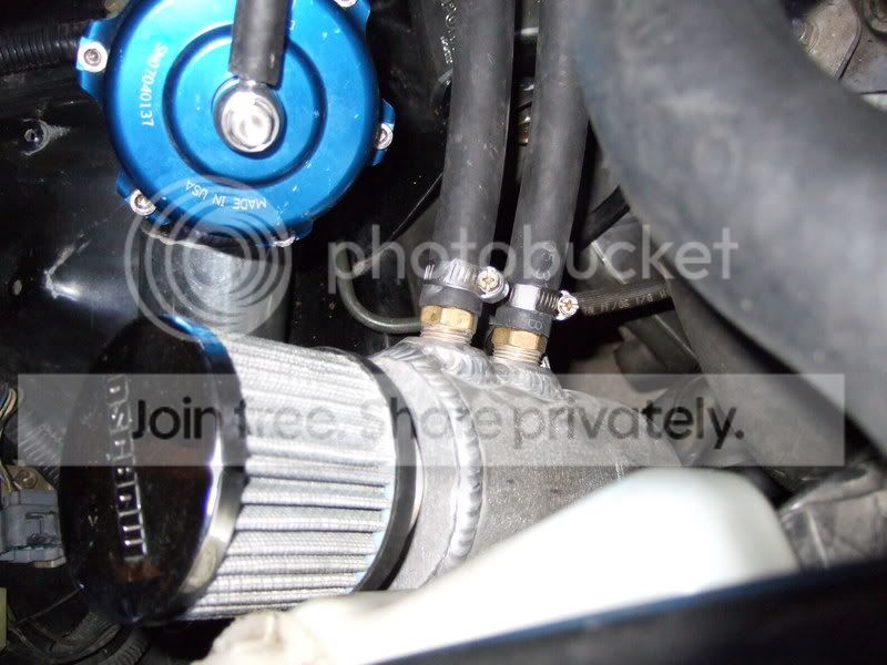

If you haven't bought the T1 fittings yet, you might want to consider buying the Honda part with the barb fitting so you don't have to worry about purchasing and fabricating lines. You would be able to just run rubber hoses from auto zone. Much cheaper and much easier.
11107-PK2-003 Honda PN for the fittings (need two)
12207-634-300 Honda PN for the washers (need two)
T1 block plug http://www.t1raceparts.com/product_p/bfp.htm
This is how my hoses look:
