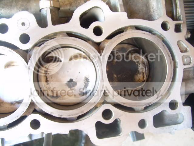

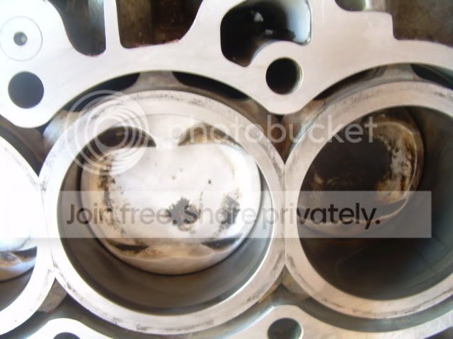

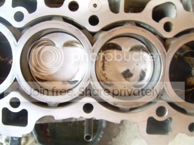

i have a build block, trying to clean it.. but cant get these black stuff off...will it matter if i just put a gasket and head on.....i did clean it...and what kind of blockguard is this

looks like a sleeved block, not a block guard.

Ding ding ding...Golden Eagle sleeved block.You can carefully scrape the carbon off with a single edge razor blade and some scotchbrite.

Just make sure everything is in order and assemble it. It will continue to have the "black stuff" only few minutes of starting the motor anyway.

just leave the carbon alone... just assemble it, if you want to clean it up afterwards run some water though it.

seafoam and a toothbrush...worked for me.

iam talking about the black stuff around the sleeves.........where the gasket set...will it leak........

Looks fine to me. My old head did that cause it had a composite head gasket. No biggie.
You could always get it decked.

so a new gasket and a head should be fine.........no oil or coolant leak.......
