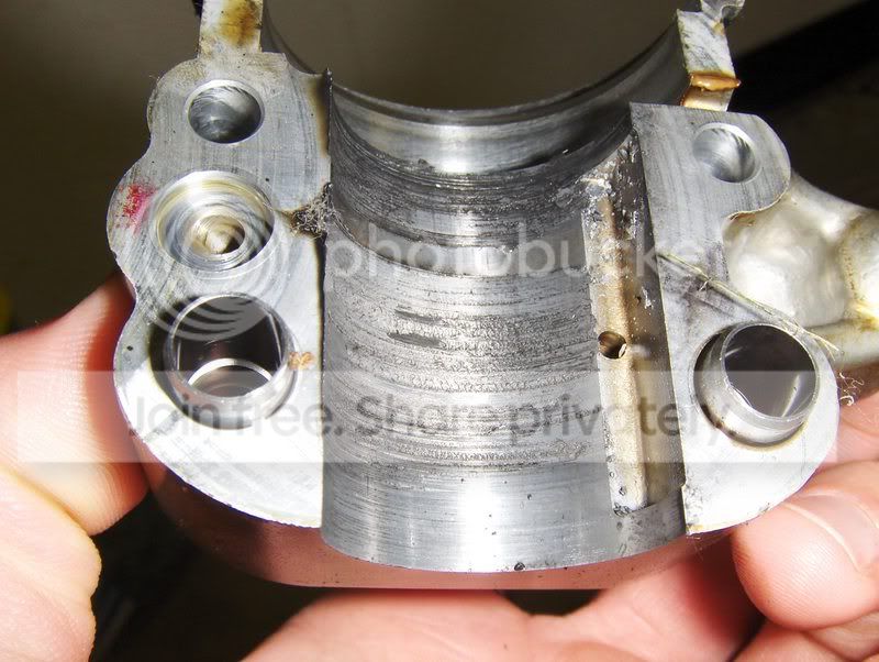

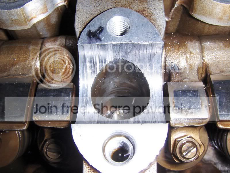

So i just went to install a b18b bottom end with my b16 head...Everything went ok, but the car only ran for about 2 minutes. I pull the cams to find this
This is the cam journal closest to the t-belt
2nd one closest to the tbelt
Cam itself
Cam cap
One more
I think i may have had my timing belt to tight, because the journals closest to the dizzy are fine, and they get worse closer to the tbelt. I don't know if this is fixable, or if the cam is any good any more

Looks like its pretty well jacked

did you have any oil in your head? see what your shop says, looks pretty well scarred tho- id say the cams are done for sure..

If the grooves are not super deep, which they don't look to be, I think it can be fixed. I know Dave at headgames has fixed some like that but I don't know the extent of the damage.
Did you even use any assembly lube when you reinstalled those cams?

That head had no oil.

you can have that belt super tight and it wont do that. that head def didnt have enough oil and you ran the journals dry

I don't think assembly lube would have saved that, you have a problem elsewhere. I usually don't use assembly lube when putting the cams in just make sure to put a lot of oil on everything.

Yeah i didn't have any assembly lube, so i just put oil all over everything...I also fulled the ECU fuse and primed the engine to get oil pressure before i started it. I am supplying oil to the head via a filter sandwich and a line to the back of the head.

you sure you had the cam caps in the right places and everything was clean
i had an itr head like that and sold it for cheap because i coulldnt get it fixed

i had the same thing happen to one of my heads a couple years ago, when i took the head off my ls vtec to put it on a gsr block i got. i had to drill the oil hole back out that was blocked for the ls motor but i obviously didnt get all the metal shavings out and they chewed up the head and cam pretty bad just like that.. so id say u had some dirt or metal shavings that worked there way in there and ate it up or blocked the oil passage.. u wanna make sure everything is very clean of dirt or anything that would clog the oil passage...

did put the caps for the cams on too tight?

Hey dumb question - do you have a "LS/VTEC" oil feed for the head?

Another dumb one, what timing belt did you use??

no oil , what way where the numbers facing when you put the caps back on ???
