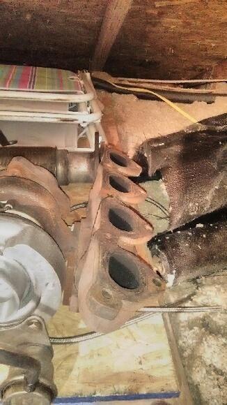

Hey. I just found a Greddy 15g kit but I'm not sure if it is really a real one. Searching the web I found some pics of the turbo housing which is possible to see writing numbers on it. The pics the guy sent me non of this informations can be seen, at least not on these photos.
The only place that can confirm it is a Greddy kit is the manifold. My question is. Is this kit original or the turbocharger was changed? I think the original one came with 3 holes to bolt on the wastegate actuator, not just 2 as you can see in the pictures. $500 for this kit is fair enough? Could some one clarify me?
The was what I found searching. Part number and 3 holes to bolt on the wastegate.
Non information marks nor the third hole.

Maybe, Shodan or wantaboost can correct me if I'm wrong but in google greddy GSR turbo kit images, all the compressors have the greddy tag.
This is 99-00 SI bolt on kit.
https://encrypted-tbn0.gstatic.com/i...Z-hNPJjszTiTuw
96-00 GSR Kit
https://encrypted-tbn1.gstatic.com/i...cqSOBL-Ti9qumq

^^ 99-00 SI and 96-00 GSR used the TD05H-18G. The "D series" kits used the GReddy TD04H-15G, came in a 8.5 cm^2 turbine housing (just over .74A/R) and did not have a tag on the turbocharger
