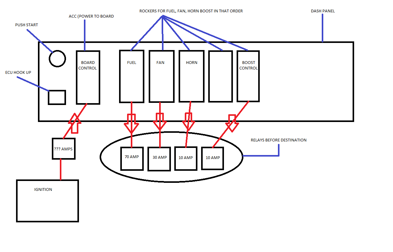

I have a good friend that is helping me wire the dash panel up next week. Should be as the image shows.

Finished wiring in the fuel pump today and tested it. All is well and surprisingly the fuel regulator kept 50psi. I figured it would sky rocket since it was setup for the stock pump. Also finished wrapping my hot pipes and made sure to cover that ugly *** Kmod logo on the manifold. Bolted all the hot pipes in and started getting the car ready for the initial start up. Gonna give Derek Robinson at Innovative motor works a call soon and pay down on my tune so I can get a base map. I don't plan on driving it under boost but I do want to drive it enough to ensure the coolant system is burped and functioning properly. Also I want to make sure all is well with the freshly built transmission and new engine before going to get tuned since I live 8 hours from their shop.
