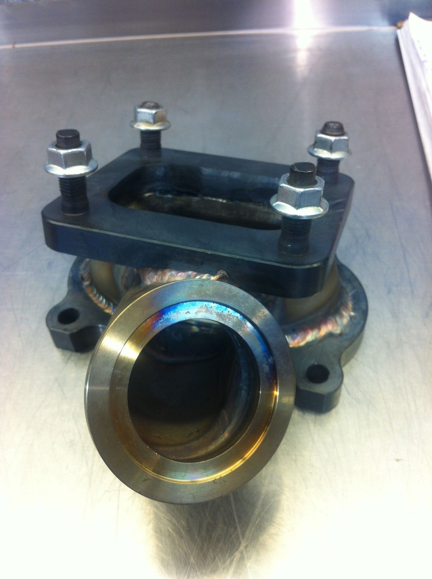

I'm thinking on pulling the trigger on the new Garrett GTW3884 6262 with the T4 .70 A/R housing (good price on ball bearing Garrett) to replace the Precision 5858 T4 .58 A/R v band outlet turbo that is dead rebuilt it but the wheels hit the housing so it needs to be replaced, but it is not clear to me if it is a direct fit or if I will have to modify my down pipe and recirculated dump pipe? or will my precision turbine housing bolt up and have it machined to the bigger wheel? if not I might just go with the new Precision 6062 gen2 ball bearing turbo and try precision one last time, QUESTION do you think it will be to laggy for my k24Z3 8.5-1 compression street driven car the 5858 running at 18 LBS starts spooling up by 2700 RPM but seems to be choking out at higher RPM's my budget is $1500 any advise on choosing a new turbo would be appreciated

GTW T4 v-band sizing is different than the one used by Precision. You have to see if the weld flange that you're using (as well as the T-bolt clamp) has enough give to clamp down on the new system. So, it will depend more upon the weld flange you're using than anything else.
As for the power level and boost threshold and whether or not it will be the same, the answer is a resounding NO. By how much the threshold changes really depends upon whether or not your in the efficient boost pressure range of the GTW3688R, which is using a MUCH larger exhaust wheel (V-band only uses the larger exhaust wheel, and not the same size as the 6262.. Its more like a 6265 if you want to compare with Precision numbers.)
Just because you're switching over to a ball-bearing CHRA with much larger wheels, does not mean its going to be have similar to what you already have. There's nothing similar to the two turbochargers in any way, shape or form.
