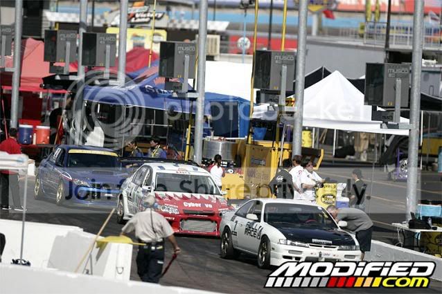

Fresh after a top finish in the Super Street TimeAttack qualifier the week before, the Full-Race powered S14-240SX driven by Brady Dohrmann squeezes out a first place in class, 3rd overall finish at the GT Live Track Attack event. The event was held under the lights at Phoenix Intl. Raceway and catered to not only to some quick local drivers, but some of the fastest time attack cars in the world - the Cyber EVO and Zero Sports Impreza.
Given the 105° heat and a recent motorswap (to 100% stock sr20) the 240SX was tuned conservatively, yet still managed a 1:07.7 lap, beating out the E46-M3 piloted by former factory BMW driver Karl Muik. Another E46-M3 followed closely in 3rd with a lap in the 1:08 range.
the setup is a 100% stock SR20 (stock cams, stock intake-manifold) with a Full-Race stage1GT turbokit and Enthalpy 550cc romtune
The S14 is almost entirely stock (stock TC rods, stock RUCA, stock everything!!!) just a 10 point rollcage, Cusco LSD and custom coilover suspension.
