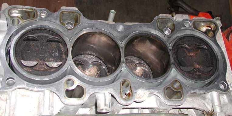

You need to stop nut riding and actually get some experience Geis. If your hero really did say that, then he would be wrong. It has been a known fact for a long time the sleeves are not thinner. The thinner B20 sleeve **** started in the early 2000's and was proved false in the mid 2000's... and a decade later due to the magic of the Internet, it's still being regurgitated...
If I must, I can dig up pictures of various engine blocks from my personal library and show they are the extremely similar in thickness. The reason I say similar, is because the way all Honda sleeves are cast leave them susceptible to thickness differences around the circumference of the bore. The true problem with B20s is like you mentioned - monocast sleeves. It leads to hot spots and they are more prone to cracking at low RPM detonation than anything. No Honda sleeve really likes being pushed to 1mm overbore.
Tony is a smart guy, but from time to time (like all of us) he is wrong (if he even said that). Thats the good and the bad of the interweb, it brings all of us "know-it-alls" together to dissect each other and we can all become smarter together. It separates the bullshitters from the experienced.

LOL... no. The distance may be "thinner" but the actual sleeve liners are absolutely not. If you actually have them then you know exactly what I am talking about. Where the sleeves meet it is much thicker on the liner... it's monocast... it HAS to be. Guess I will have to post my pictures afterall huh, even though there are thousands on the Internet for you to copy already.
Old Dec 21, 2015 | 06:08 AM
OneBadTurboCRV's Avatar
DO IT ON ALL FOURS
Posts: 7,632
Likes: 15
From: IN Your Mind
Default Re: First turbo build

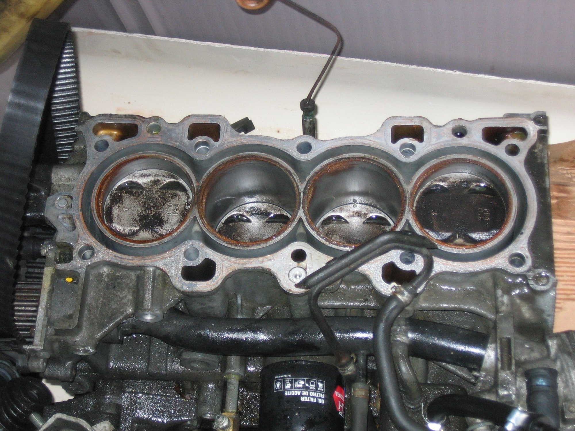

Here, since I think you have a secret obsession with seeing my stuff I found a few picures. Yes these are mine, if you want more angles just ask. Sorry, all my spare blocks are sleeved aside from some D-series, a B16, and B18C. The only LS style blocks I touch are B20s...
I have one of a B20, and to support my very uneven cylinder thickness claims a B18C, and finally a B16. All of these are engines I built for myself, I have many many more but I think it's out of context for all intended purposes. Enjoy!

Is the second photo the GSR block? That is a crazy amount of material thickness variation from sleeve to sleeve, almost as if one bore is larger than the other. The B16 looks fairly consistent.
The few B20 blocks I've had always appeared to have dead on uniformity but I didn't look much into it, from what I can tell it has always been the siamese nature of the liner that lead to failures
Yes, it's a early USDM B18C1 block that isn't uniform in the picture. It was bored 0.5mm over and had PR3 style pistons installed (N/A setup). I have included the full picture below, which isn't the best due to the oil, but I never intended to use it for anything other than memories... It's one of probably 1/2 a dozen I have seen / owned that weren't uniform liners. That B16 is actually a very early JDM B16A block.
Yes, if the failure isn't somewhere on the side like a regular block it almost always happen on the thickest part where the two rounds liners meet. A quick Google image search will show tons of these types of pictures.
All this just goes to show the inconsistencies you can find and aside from tune, could be why one person can make stock sleeves last and another person with an identical setup blows up way short.

Hence the photos I posted, there is quite simply less material between the cylinders on the b20 than the b18, this is an infallible statement.
Less material = Less structural integrity and less heat dissipation. To say that this also doesn't lead to cracking is ignorant at best.
