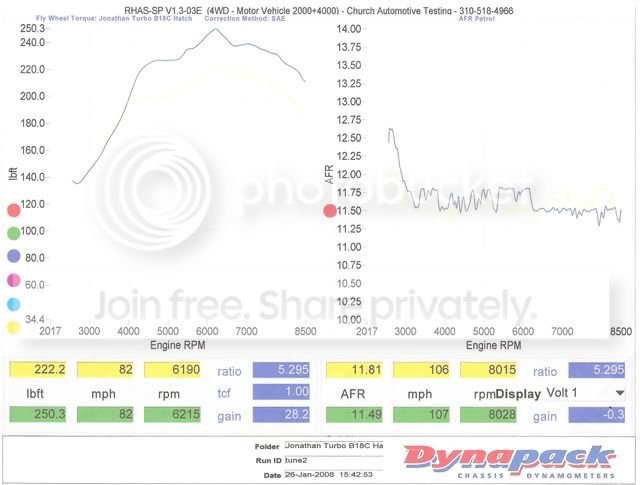

here is the set up
94 b18c
99b16 tranny with type-r final drive
LA sleeves
cp 9.8:1 81.5mm pistons
eagle h-beam "big bolt" rods
spooling performance "quick4" manifold
skunk 2 IM
gsr cams
custom turbo by the shodan "silver surfer" t3/t04b 60-1
3 inch downpipe-muff
44mm tial wg
50mm tial bov
peakboost FMIC and piping
supertech springs valves and retainers
s300
Here is a video of the last pull.

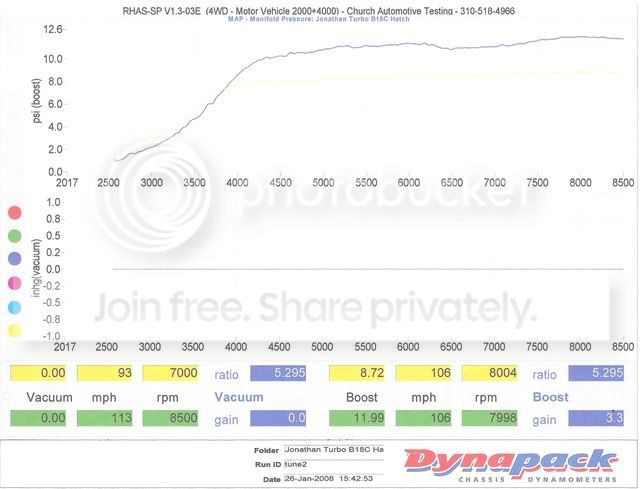

motor made 307hp and 222ft-lbs at 8.7 psi.
at 12 psi motor made 346 and 250
I will have charts up in about 20. Took up way to much time getting there and fixing little things. I did not have that much tuning time. I need to go back badly to fine tune the curve.

all that for ~300 whp?
what injectors do you have ?
ps turn the boost up !

i know. 91 pump gas over in socal kills.
will be back with race gas and 500+hp
750cc

Im on 91 pump gas and made 416 on 15psi with a 60trim. Turn it up a couple more lbs. The motor is begging for more!

first things first i need bigger tires. lol i cant even put 346 to the ground
now i think i fried my elect boost control solenoid. got wet from splashing up some rain onto the firewall so now im stuck at 8.7 psi.

Graph looks good what part do u need to clean up?? Church does great work!!

well look at my torque curve. it peaks at 6200 rpms which at that rpm im making 11.2~ psi. it makes more there than when the boost creeps up about another psi...?? maybe im just crazy?
plus there is a small spot when i just barely touch the gas in 1st when taking off from a stop where it bogs. they did a great job though.
