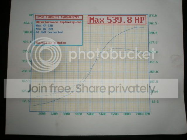

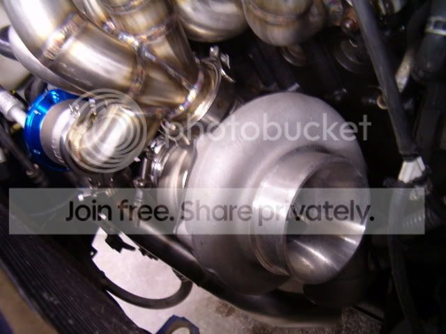

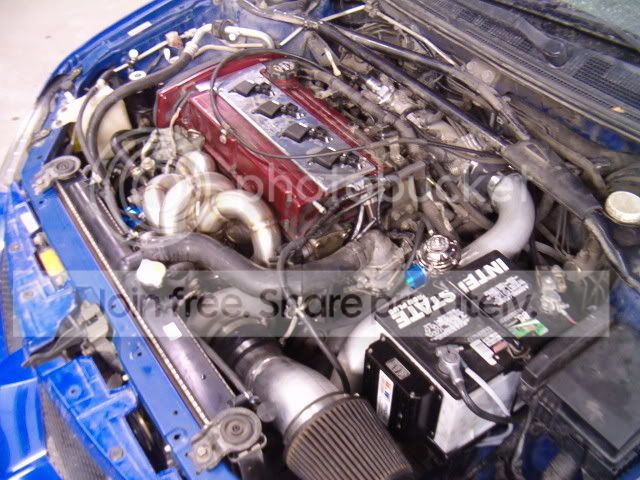

Tial GT35R .82 AR
TIAL 44mm wastegate
PTE 1000cc injectors
Walbro 255HP pump
Kelford 272 cams
Spark Tech pro series igniton
AEM EMS
24x10x3.5 FMIC 2.5" IC piping
Stock longblock(other then cams)
407awhp @ 19 psi 91 octane
473awhp @ 25 psi 91 octane
539awhp @ 27 psi 110 octane

*a side note, it's a Garrett 35R with the TiAL hotside

any reason you guys didn't tach it up to 8000? espeically with the kelford cams/valvetrain, those things are tasty... i wonder how kelfords honda stuff is...

im only focused on how sexy that mani is

That is just shy of 8000rpm. A/F started leaning out so the session was stopped there. Its still a single walbro pump and stock FPR.

Nice manifold and 35R upgrade. Too much - too good.
Makes me want to say Hey! This is a Honda forum - just out of pure 4wd traction envy. Did it change streetability at all? Clutch difference?

oh crap, thats not bad for a single walbro, 35r evo's redline quickly once the boost comes on, thats why i asked, that small 600rpm helps... but yeah better safe for sure!

Planning on dual pump kit and aeromotive FPR shortly then back on the dyno w/ some more boost looking for ~600awhp.
