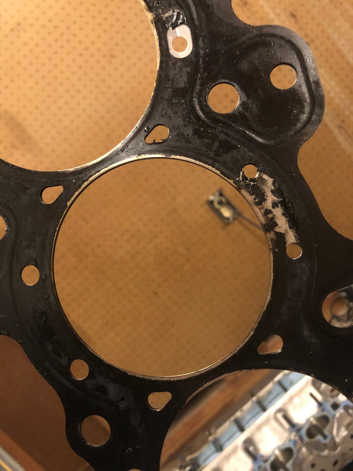

Good news/bad news.. The engine temps are great after the go autoworks radiator and fan shroud and fixing the coolant leak... never seen over 200 today, but I noticed today after running it pretty hard that the coolant reservoir was past the MAX mark and bubbling. I took the car home, drained the reservoir down and hooked up the lisle funnel and again followed TheShodan’s steps.. after idling an hour, still getting the occasional bubbles on top of an oily film in the funnel and some random black **** floating around... brand new coolant & radiator. I do believe the head gasket is gone and likely from getting way too damn hot last summer.
Now would be the appropriate time for me to send the manifold off and get it coated also.
What do you guys think about the golden eagle advance seal head gaskets?

Isn't the golden eagle head gasket essentially an OEM gasket? I thought I remembered hearing that. I've been running one for about 500 miles over the past few months and I haven't had any issues.

I believe that they are still the OEM modified head gaskets. I'll be picking up one this week for my rebuild project as I only use OEM gaskets when I can for 84mm.
As for Jimmy's manifold, you want to coat it as soon as you're done for the season or whatever. Your car will be down for a couple of weeks, so have other transportation ready if this is your only vehicle. The coating doesn't flake off, but it will scratch off, if you're not careful during your re-installation of the manifold. so bubble wrap the slave cylinder nipple and other items that "poke out" so that you don't scratch the finish of the coating.

Well... that’s where there is some confusion. Golden Eagle has two head gaskets. The OEM Honda and then their line up... the golden eagle “advance seal” which is made by them. Both are similar in price
I’m contemplating trying something different... I’ve read a lot of good stuff about JE Pro Seal.. thoughts on this?

GE only sales the advanced head gasket on their site which is a modified OEM head gasket. i have one on my motor and if memory serves me right, they stamp it with their logo and or bore it out to bigger piston size.

Thats not the impression I am under after talking to them on the phone. He said the cost of OEM gaskets kept going up so they made the “advance seal” line up...

Just wanted to update, I know it’s been a while... life has been busy.
Had a buddy come over today and we got the head pulled off.. definitely a blown head gasket, and that explains a lot.. but what do I have to do to prevent this from happening again? Turn the boost down?
Could this be from the head lifting?
