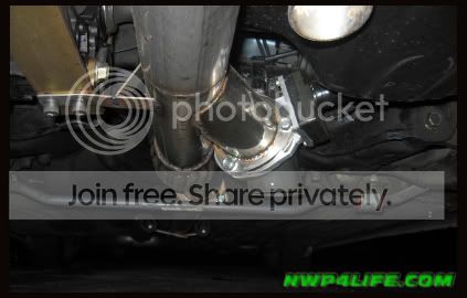

Looking into doing a E cutout on my DP. I worry about how they hold up and how people like using them. Maybe the better brands? Input?
Looking to do something like this

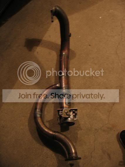

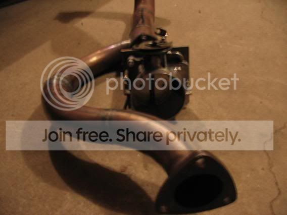

i have a race ready performance e-cut out, similar to cheezefrog's set up from a while back. mine leaks, and rattles. its a pain in the ***, but sounds amazing. my car looks junky anyways and my exhaust cost me like 150 bucks, so i dont mind too much.
[IMG][/IMG]
[IMG][/IMG]
[IMG][/IMG]
