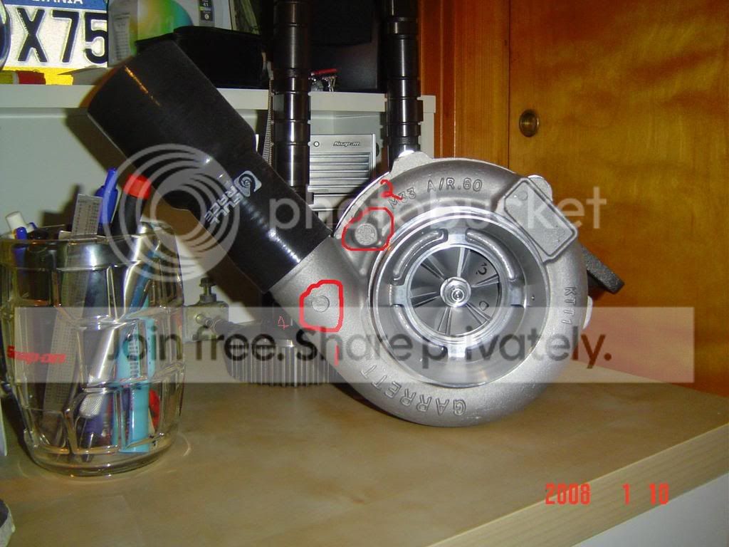

should i tap 1 or 2 in the pic
[IMG][/IMG]
Old Mar 16, 2008 | 11:25 AM
RACEPAK's Avatar
Posts: 7,434
Default Re: full-race (ctr83)
i would use the 1st'.
if you have enough room.
Old Mar 16, 2008 | 11:31 AM
93supercoupe's Avatar
Posts: 2,852
From: Dont Steal My Car, Ct, USA
Default Re: full-race (RACEPAK)
yeah, number 1 fo shizzle.
Old Mar 16, 2008 | 02:42 PM
ctr83's Avatar
Joined: Oct 2007
Posts: 240
From: pa, us
Default Re: full-race (93supercoupe)
well #1 it is. thanks guys

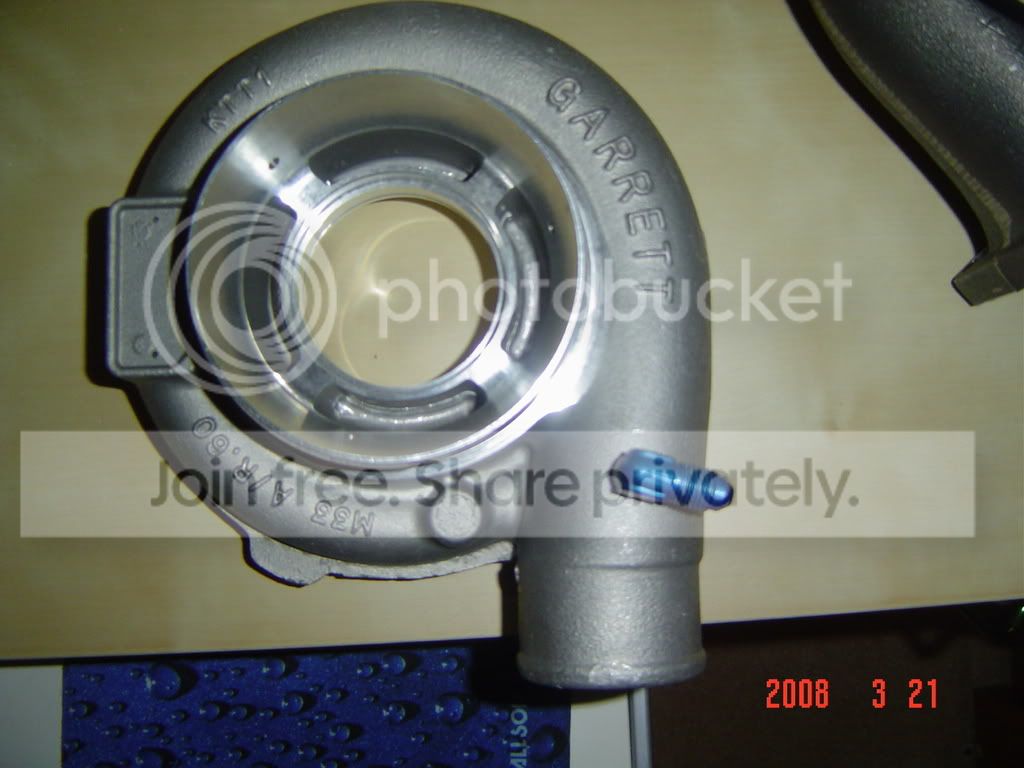

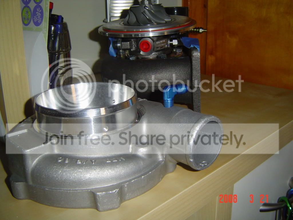

i taped my housing today. i am going to use push-loc fittings. what do you guys think[IMG][/IMG]
[IMG][/IMG]
Old Mar 21, 2008 | 02:41 PM
moores55's Avatar
Posts: 774
From: somewere, tx, usa
looks good.
