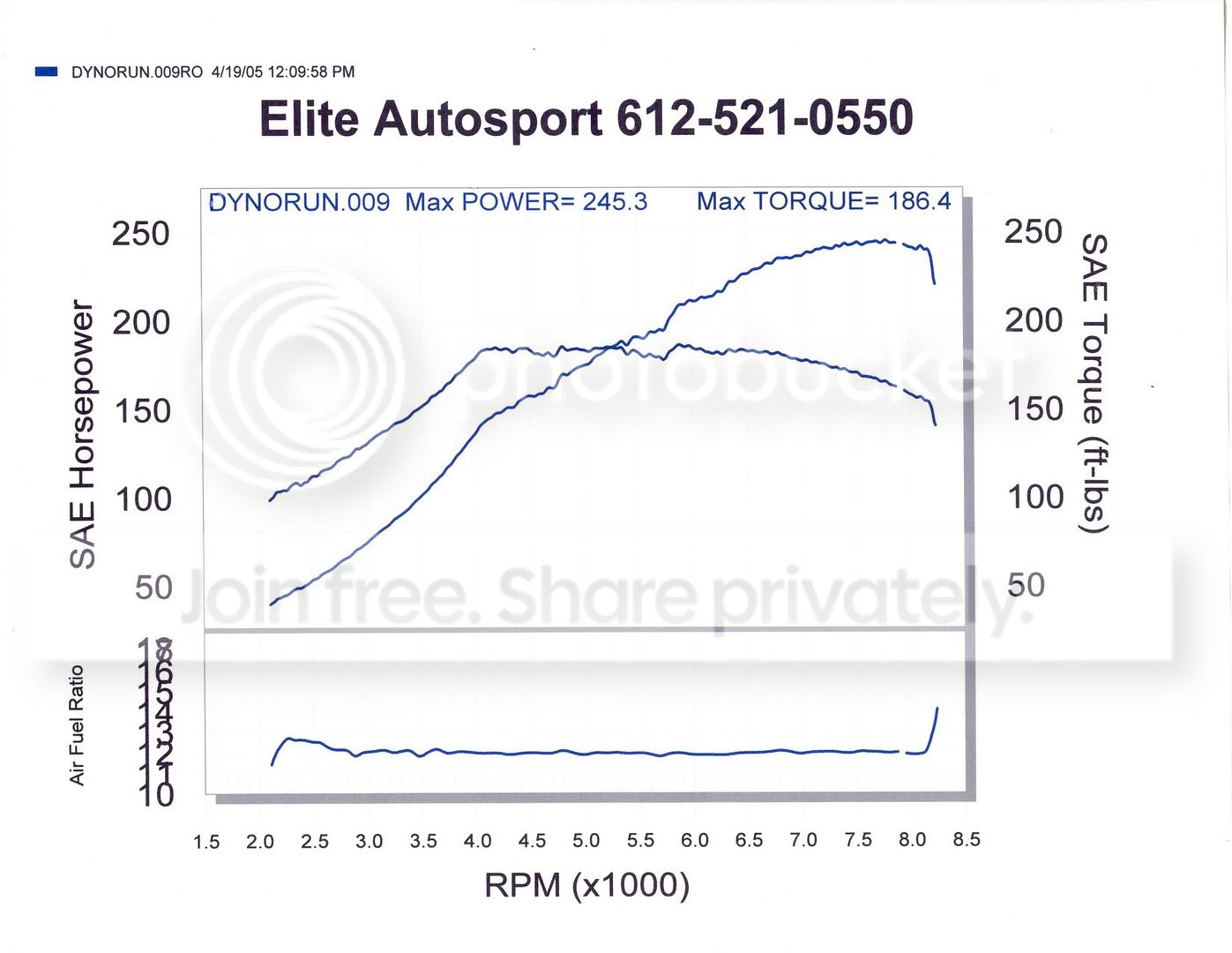

Here's my dyno chart on 5.5 psi on vafc2
And here's my dyno chart I just got done today running on 7 psi. Only thing that change was vafc2 to hondata, replaced cat. with test pipe, and replaced 2.25 in comptech exhaust for 3 in. kteller exhaust.

Screw you to all the afc hack haters ... proof that it works

yeah...works BAD

Although the extra 2psi, removed cat, larger exhaust couldn't have hurt hehe.

What motor was this on? Why is the torque so low? You think you'd be in the 200s with torque..hmmm
I have a gsr that used to run on the vafc2 and I was running 6psi with crushed bent 2.5inch exhaust and a test pipe and I was pushing 215hp and 185tq. Tuned at rs-motors

This was on a stock gsr motor and I don't know why the torque was so low either. I'm satisfy with the tune for now. It sure beats the 171 hp I had with the vafc2, plus I don't have to worry about the vafc pulling timing anymore.

umm no, his torque is fine....look at the thread titled boosted hybrid tuned orange gsr...same torque on a stock gsr motor

Im pushing .5 more pounds than he had and have the same setup. Why is my torque 185 at the wheels and his was 141 at the wheels on the vafc2? I dont think i gained more than 40 ft pounds from the 2.5 crush bent piping. Doesn't seem normal to me. I had hondata on a 98 gsr with a t3/t4 (same as what i have now) tuned @ 295whp and 230wtq. That was with stock internals. I'm sorry, but that's low torque for a gsr.

Those numbers are pretty funny.
As one who was on the hack, and is now on an uberdata, I can vouch that it is not very effective engine management.
However, for what it was, it was awesome. Much better than an FMU, and even though my car bucked like crazy it was still pretty quick and fun to drive.
