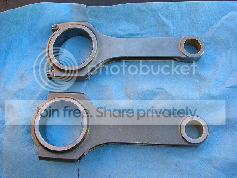

BTW: the pic posted is a D series Eagle Rod (top) VS this company D series Rods(that for now i will keep it for me) .. Oviously for D series this rod is Massive and overkill, it handles waaaay more power than what can be attained on a D series engine... Thats why it needs to be modified to suit more the actual demand , but this same rod for B series its perfect.
Let me ask you something..in case of the D series..Would you pay $300 for eagles that handle 600whp..or would you pay $250 for a rod that will work the same or better than eagles and will handle 600+ whp?

here's another pic..

well gentlemen this is not a for sale post.. i would like to keep it technical..Price hasnt been established yet as it depends on many factors but they wont cost more than Eagles..
The rods will be modified for D16 engine since right now its huge and it will require more notching than eagles..So it will be modified to be close to Eagles spec but handling more power at a cheaper price..They will probably lighter than eagles too...Right now, as fat as it looks, they weight the same as the smaller Eagle rod so even though they are fatter there is no extra weight for the rotation assembly.
I will also be bringing an I- beam for D16 that will work specifically for Vitara pistons..Bringing the piston up flush with the top of the sleeves and proviving more Compression on d16 engines (Around 9.1-9.3:1
