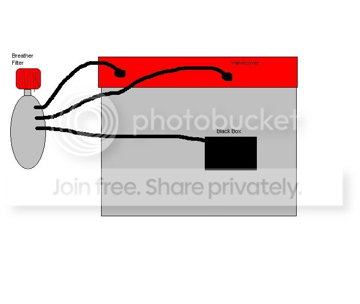

OK, so this is what I'm thinking.
I will cap the nipple on the intake manifold and then remove the PCV valve and hose. Then, as you can see, run a hose from the black box to the catch can along with two from the VC.
The catch can will be topped with a breather filter.
or ?
Old Jan 31, 2007 | 09:10 AM
93turbo16's Avatar
Posts: 9,743
From: Carlisle, Pa, USA
That should work just fine.

Default Re: (93turbo16)
<TABLE WIDTH="90%" CELLSPACING=0 CELLPADDING=0 ALIGN=CENTER><TR><TD>Quote, originally posted by 93turbo16 &raquo;</TD></TR><TR><TD CLASS="quote">That should work just fine. </TD></TR></TABLE>
Dandy.
This is for a turbo application, BTW. Pushing 18 psi at the most. Sure it'll work with the PCV gone and everything?

Default Re: (RyanEJ8)
I guess you're right. I could just vent them to the ground if I am gonna vent them to the can anyway.
So would you reccomend running a can or just dumping to the ground?
Any effect on the way it works? I am thinking a can may be better cause I can see if I'm losing too much oil or something.
Old Jan 31, 2007 | 09:50 AM
93turbo16's Avatar
Posts: 9,743
Default Re: (Tippyman)
<TABLE WIDTH="90%" CELLSPACING=0 CELLPADDING=0 ALIGN=CENTER><TR><TD>Quote, originally posted by Tippyman &raquo;</TD></TR><TR><TD CLASS="quote">So would you reccomend running a can or just dumping to the ground?
Any effect on the way it works? I am thinking a can may be better cause I can see if I'm losing too much oil or something.</TD></TR></TABLE>
I like the catch can method. It lets you actually drain back if the can gets full and what not, but you can kick out a lot of oil, if you have a lot of blow by. So the can could get full depending on the boost and the level of blow by you get. I just wouldn't want it all over the bottom of my car, so I would run a catch can.
