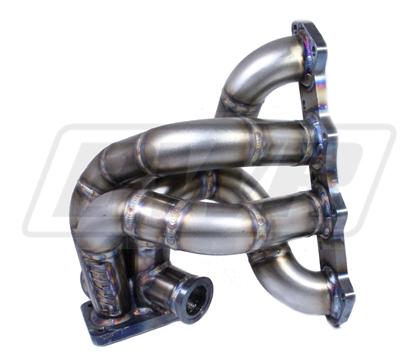

Default Re: Custom Forward facing turbo manifold
We can get you a brand new one from BWR. I've used them in the past with Great Results. Lifetime Warranty too.
Something like this. You can get it T4 with Dual 38MVS or Dual 44MVR
Dual MVR Setup $899
BWR Turbo Manifold - Rickspecd
Dual MVS Setup Setup $899

that manifold places the turbo in the lower bumper opening/under where the bumper beam would be, not the grille.
and any manifold that hangs the turbo that far out needs bracing, regardless of material thickness, as it will eventually crack. the reason manifolds like a mini ram, top mount, or ramhorn don't *normally* need bracing is because the weight of the turbo is placed inline with the head flange.
