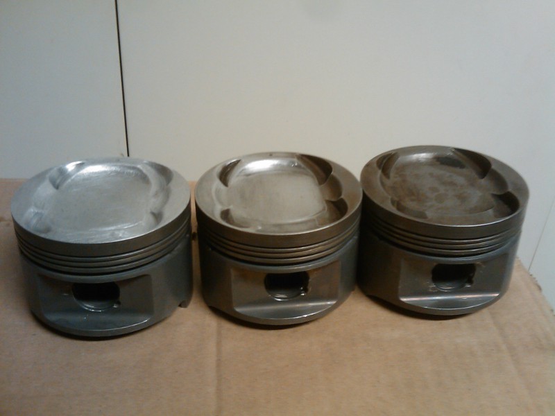

The most difficult thing to determine is what occured first...
A piston that is erroding away, will create localized hotspots at the edge of the broken piston, thus, it will increase the chance of detonation double-fold. If the piston is beginning to break apart, then it will create all those symptoms of detonation afterwards.
However, prolonged detonation will always show marks on the piston tops and the cylinder head. This doesn't seem to be the case at all based on the pics.
From the OP, timing and AFR was good, plug heat range was good, and water/meth was only added with no change of tune.
There is a reason why all the newer Wiseco pistons have that thin spot totally milled down.

To me it looks like the design is still somewhat flawed, this is a new 83mm 9:1 cp, the valve relief area is really thin to me
my JE's were not like this. I talked to cp today and they obviously blamed the tune. I thought the reliefs were revised from a few years back

It doesn't surprise me that people are giving advice and answers without even being able to tell what aftermarket sleeves look like. There is not enough solid data presented to truly evaluate and determine what happened.
We all know its the weakest part of the piston, so it will be the first part to fail. Generally speaking when I see pistons in that condition its caused by a combination of high heat and detonation. I would reconsider your tune and power levels on pump gas.

My new engine is ruined as well.... 84mm CP 9.7:1 pistons. Detonation looks like the culprit... Funny thing is, only 75 miles on the motor. No boost (bypass valve zip tied open) and no VTEC. I just sent the injectors off to RC to have tested. It was my number 4 cylinder that came apart both on the stock ITR block/pistons and the Benson block/CP pistons. My guess is a clogged injector. Running RC 550cc Saturated injectors that are about a year and a half old.
Mine was a new build as well, cyl 4, maybe 100km on it. Brand new ID's on it
