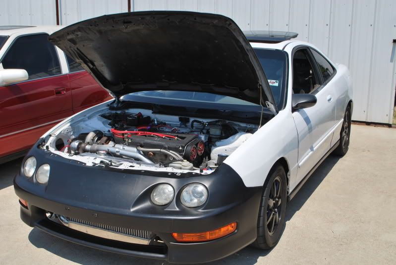

Default Re: cooling/radiators/good/bad put data inside please---->
I've got a Performance Radiator, (similar to radiators.com) a shop we use for factory replacements through work. It's a dual core copper with a black temp-coating on it, cost $105. I've got an Autozone 12'' electric fan placed in the puller position, costs about $43.
It's on a 94 Integra with an un-cut front bumper, and a 31x12 intercooler. I've got roughly 3'' of space between my intercooler and the radiator as they are mounted.
I have not seen temps of over 185 degrees on the street, even driving home yesterday in 103 degree heat. I think the hottest I've seen was 195 degrees on the dyno, and it was only requiring about 5-10 minutes between pulls to cool-down.
Proof that high-dollar cooling systems are not required inorder to keep things cool, the only thing I can summarize from it is that the copper radiator is bad ***, as the fan is nothing special and I'm not running anything other than simply coolant and water.

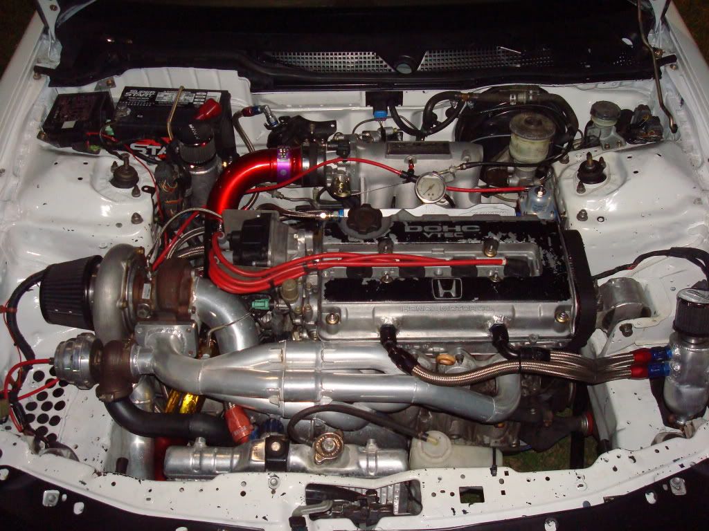

Originally Posted by HiProfile
Cheap header wrap costs all of $25 from fleabay, and works great. Honestly if you can't afford $75 for a real fan, let alone $25 for wrap, you shouldn't be driving a turbo car. What would you do if disaster struck your motor or turbo??
Back to the rads, you have to understand radiators and air-air intercoolers are very different. One has internal fins, the other has a far more efficient temp transfer medium. If you have a crap fan like 90% of the people here, the extra fin density may hurt rather than help. The truth is that most of the battle is with radiant heat and airflow, not the radiator itself. If your manifold/turbo dump heat directly into the radiator, or can't flow air through (or over to) the radiator, you won't have a snowball's chance in hell of removing any heat from the coolant.
PS aluminum IS a good conductor of heat, just not the best. You can easily overcome its 30% handycap over copper with >30% more surface area, which incidently still weighs less. Copper is 3.3x as dense as aluminum...
Ur gonna header wrap this beautiful header? [Dr. evil] hmmm yea roight[/dr. evil]
Its not necessarily that I dont have the money, but since I have the turbo kit I have, everything is custom one-off and even if I bought a shroud that "should" fit it prob wont, and I dont have a way to weld aluminum anymore. So fabbing is kinda out of the question. Besides it works 100% better than it did now with the full size radiator.
Hmm, does being pretty somehow help the vehicle perform better and in turn be more reliable? Heat is just about the arch enemy to any setup, most especially a boosted one. So while being pretty looks fantastic in pictures, it probably shouldn't matter in the least. Just my $.02 of course.
Besides, it'd match the valve cover.
What, my v/c not clean enough for a show car
Its an old pic, it looks just fine now ***
Besides thats why everything was ceramic coated. The original owner was trying to cut down on underhood heat some.
