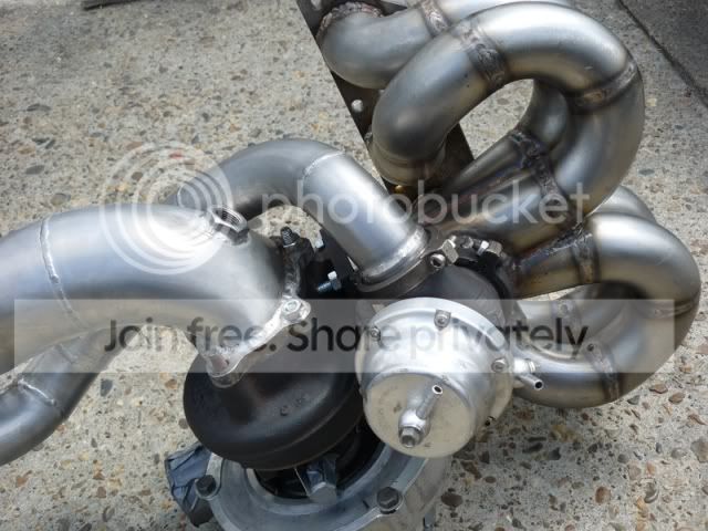

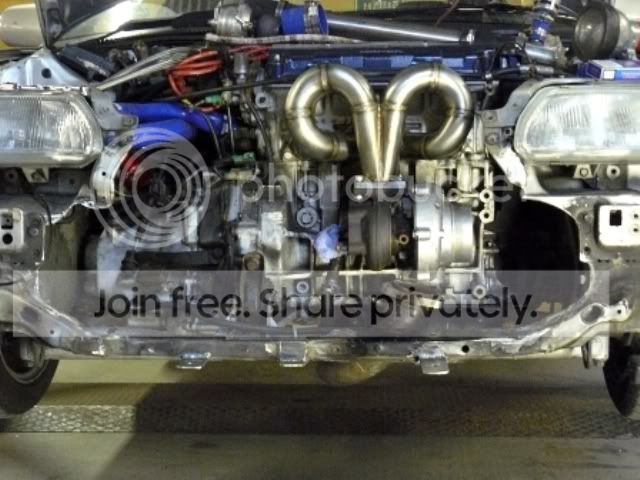

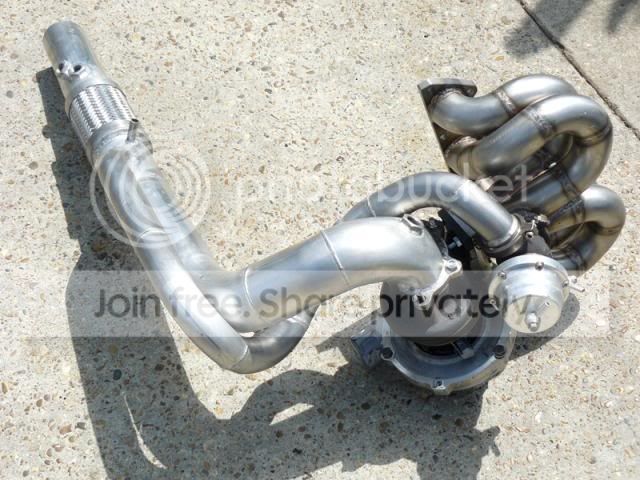

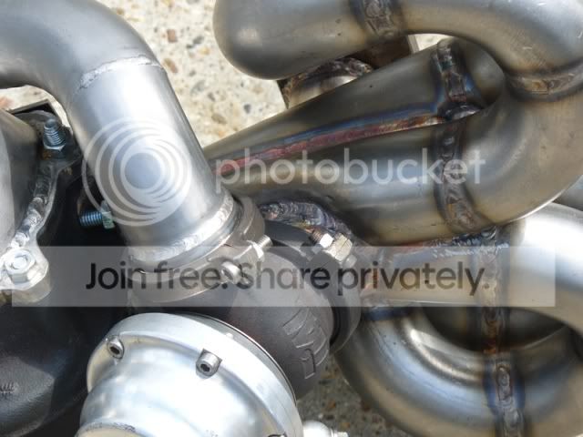

I’m interested to hear comments about the new set-up, mainly the modified take off for the Tial on the Neukin and the down pipe with the screamer routed and merged low down.
Being a CRX things a pretty tight at the best of times, extensive modification to the lower panels to make the rad fit, this was made easy due to the tubular front cross member, note, we reinforced the panel were material was removed.

looks sweet, but I'd never put my o2 sensor that close to the turbine, IMO.
Otherwise, the fab work looks great, the integration of the dump tube is very nice.

In all honesty, probably not going to use the top port, we have 2 just after the 3 inch flex.
I was a little concerned with the screamer, if it’s too long and the point it merges back into the main system.

the setup looks great. the wastegate tube is perfect. totally ideal.
