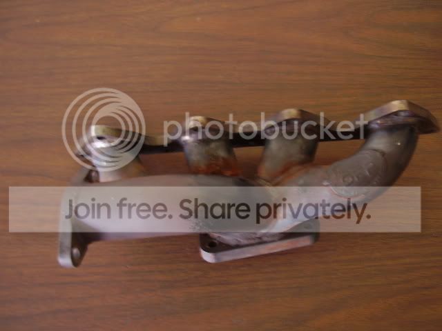

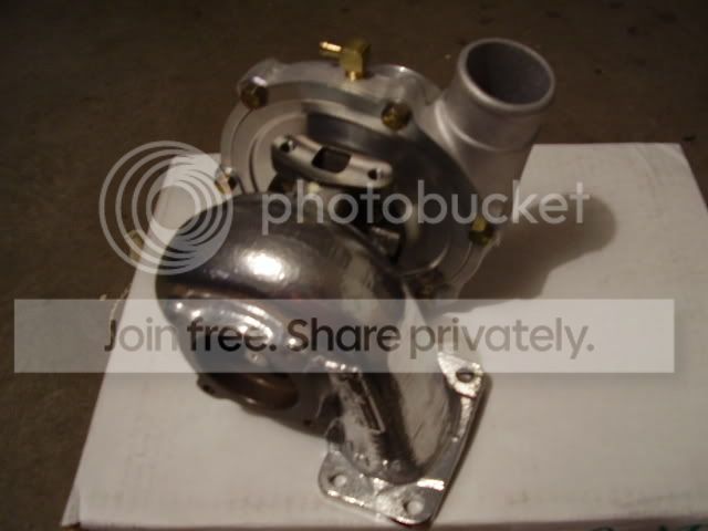

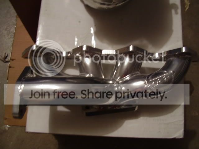

before
after
turbo
Coating was done by the shodan.I was happy with it considering what the manifold looked like before it was coated.The manifold ended up cracking later though
