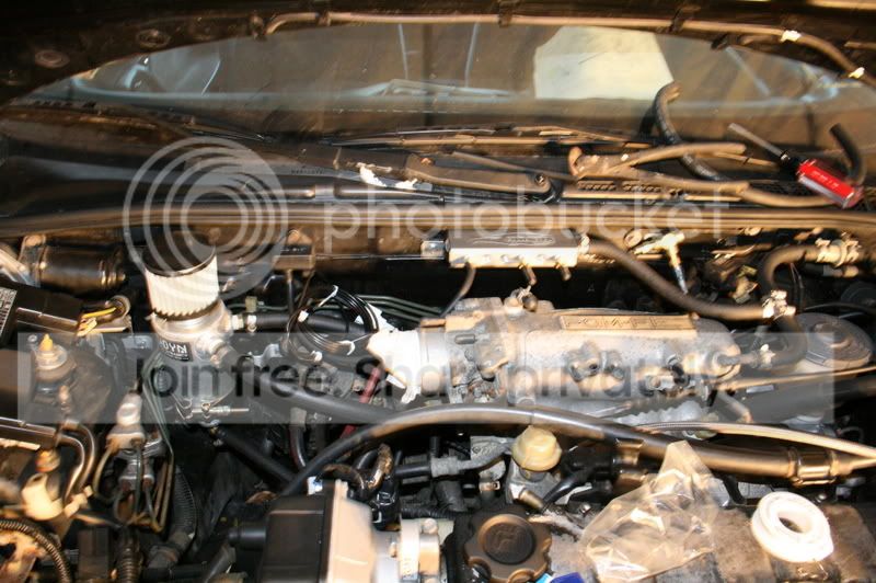

yes you are right. you run the vacuum mani off of the break booster line (before the check valve. which is a little metal thing in the vacuum line. you can feel it if you squeez the line.)
heres how I did mine. sorry the pics is blurry.
